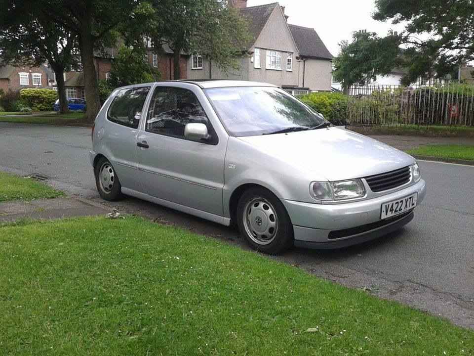

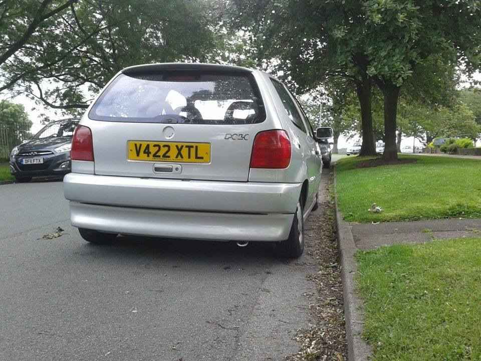

everyone one here likes photos so get a picture of the car up
Edited by residentmelon
When you buy your new tappets open them up put them into a container and fill the container with fresh oil and leave them to soak up oil for about 24 hours. Just to help it along when you put them in and start it the first time.

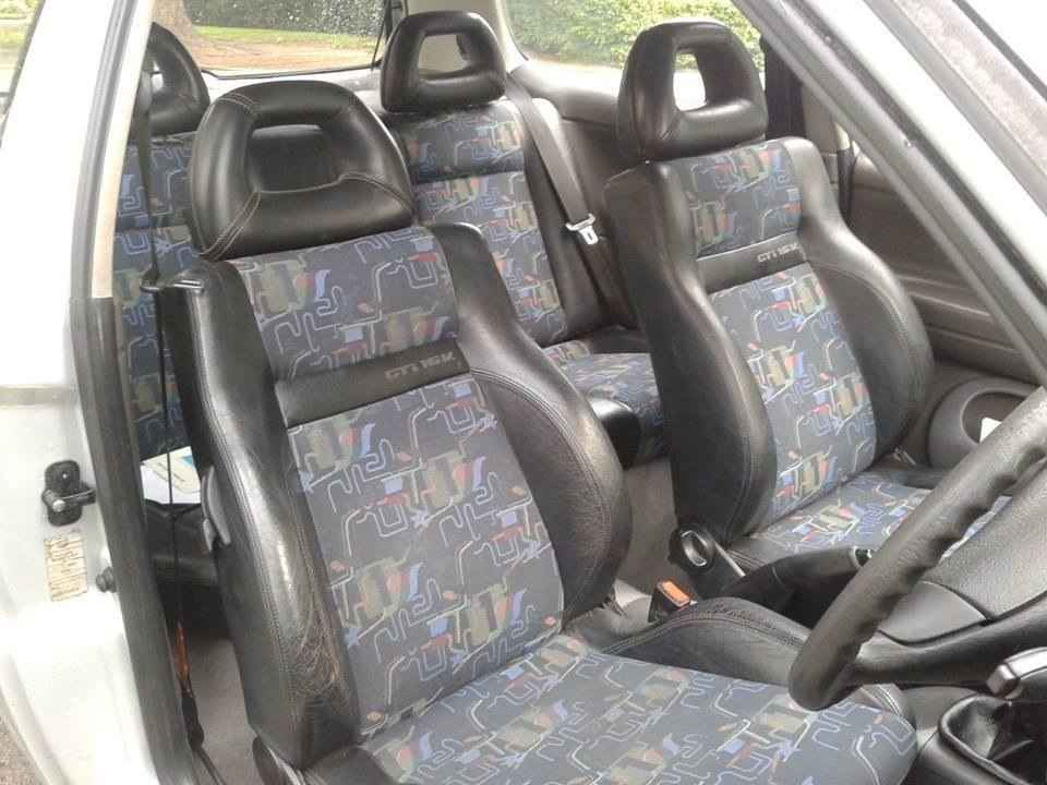

So here's the car. It's at hubby's work at the mo but will get a photo of the camshaft so you can tell me what you think :)
