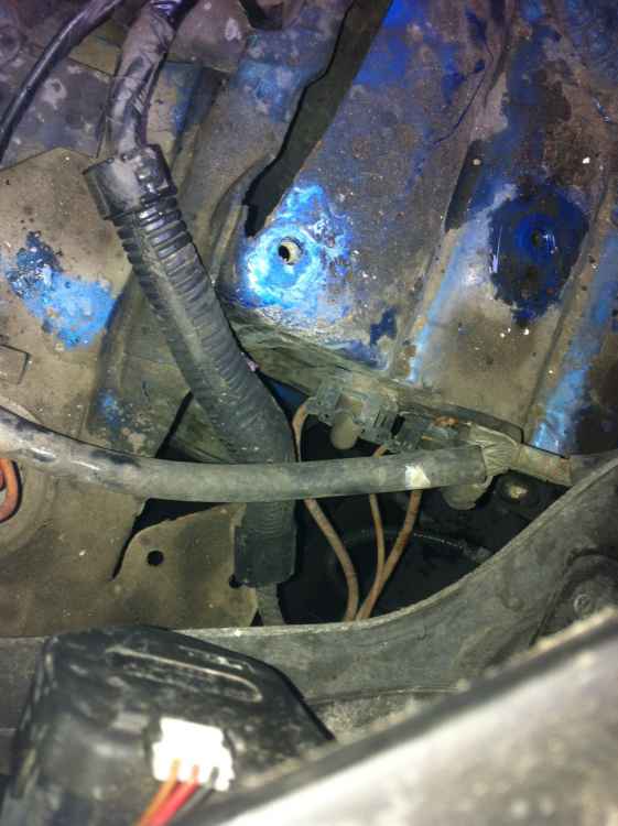

I'm guessing i dont have a control unit then? just some thick wires connected to each other using studs and nuts?
Difficult to tell from that picture, but the area I've highlighted in red might be the top of the unit??
just checked theres nothing there at all mate i think thats the horn you can see the top of?
