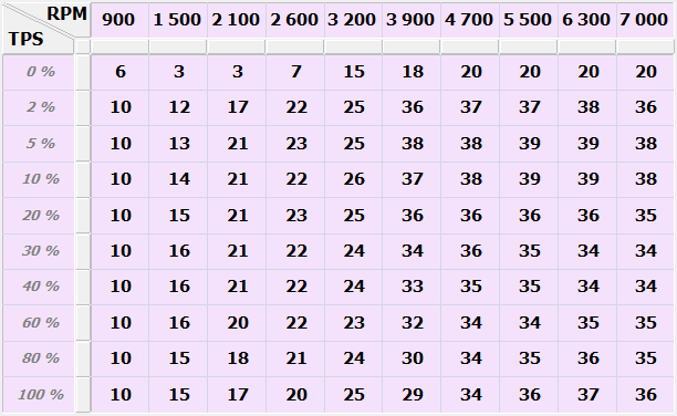

Here is my RR pre-tuned ignition map.

Ignition doesn't look miles away from how I'd imagine it would end up.

Although, everything seems to peak a bit high up the rev range, was the RR calibrated correctly?
