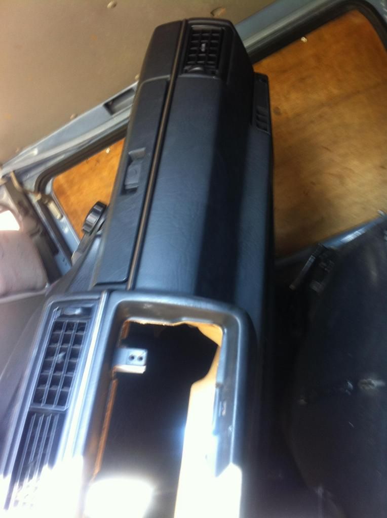

I also picked up a mint dashboard which should be with me shortly. I'm hoping to get the engine running and be able to test the heater so if there are any problems I can sort them while the dashboard is off rather than having to pull it all off again at a later date
