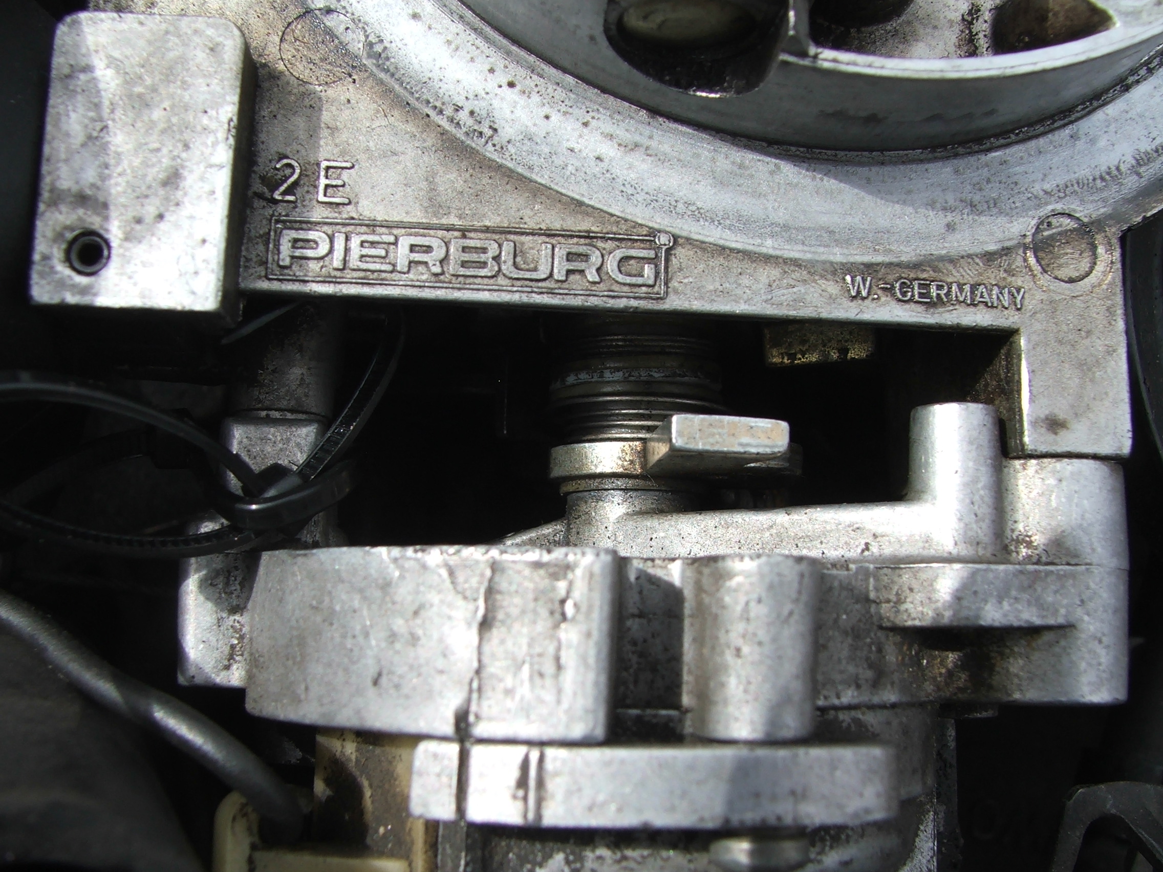

hi, I have a pierburg 2E cab, and the choke is being held open with a cable tie, will have a pic of this tomorrow

it all depends on that is said after you lot has seen the pic
it looks to be the Bi-metal choke assembly has bit-the-dust
the cable tie is holding the choke fully open I think, and when you remove the tie there is little to none tension in the spring

Shouldn't there be the end of a small spring around the nub where the cable tie is attached?
I can see some of its coils around the choke's axle below the RG of PIERBURG in picture 2.
Has someone taken off the auto-choke and dislodged that spring. But surely that spring pulls the choke closed to impede air passage, because the bimetallic coil inside pushes the flap open as engine warms? Confused :?
