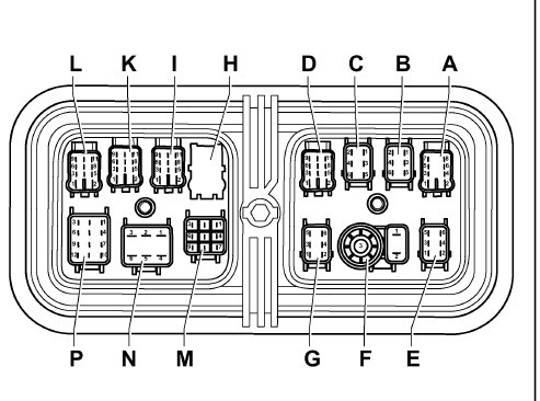

You need to take the long pin that is on its own and put that into plug G on the bulkhead. This should be a red one.
To remove the connector slide the metal bar across and then unclip it. You should have to remove a bit of purple plastic from the plug to get the pin in. This pin should go into pin 6 on the connector. They are labelled on the plug but you can also use the image below for reference.
Once the pin is in then replace the purple plastic, plug it back in and then slide the metal bar back across. MAKE SURE THE PIN IS IN THE SAME WAY AROUND AS THE OTHERS!

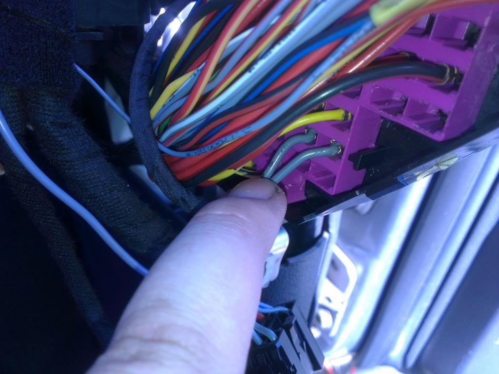

Next there should be 2 big metal pins. These need to go to the fuse box. They need to go to fuse 44. Use your manual to find this fuse.
You will need to remove a piece of plastic from the side of the fuse box, and then the big bit of purple plastic should slide across allowing you the enter the two pins. There is no set way round they should go in the two holes.
Once they are fully inserted then push the plastic piece back and replace the piece you removed.

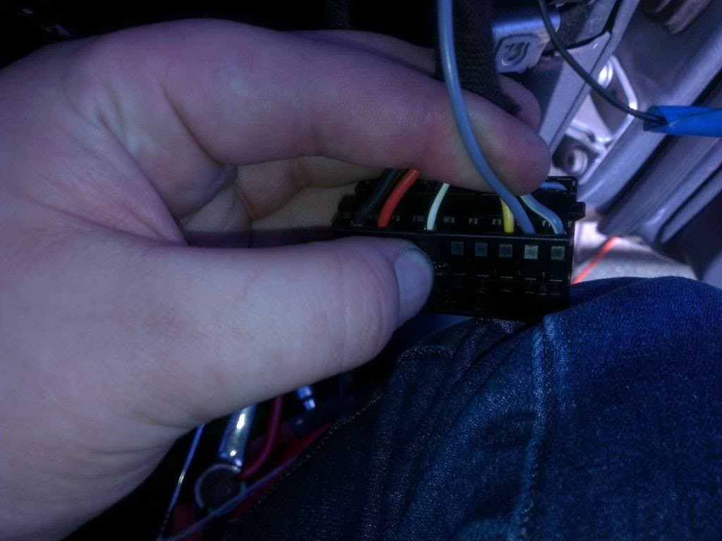

Last job in the cabin is to take the last remaining pin and put it in pin 8 on the new light switch. Again they are numbered on the plug but use the below picture for reference.
