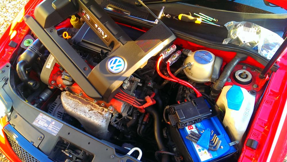

So been having a few small issues with the GTI, first was an electrical fault causing the engine to run on 3, traced the problem down to a fault HT lead which was shorting onto the rocker cover. Unfortunatly this fried the coil at the same time so had to buy a new coil
Decided to buy the best coil I could, cost a lot but seems to make her run much better, done a bodge repair on the lead until I can afford some performance Magnecore 8.5mm ones :tongue:
So engine cover and old coil off

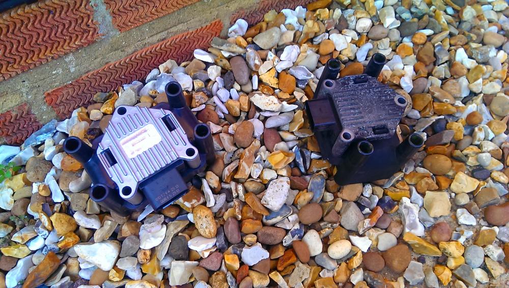

Old and new coil comparison, don't look any different lol

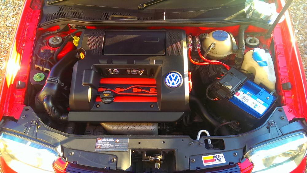

Then as I put everything back together gave it a bit of a clean (love the look of the standard GTI bay)
