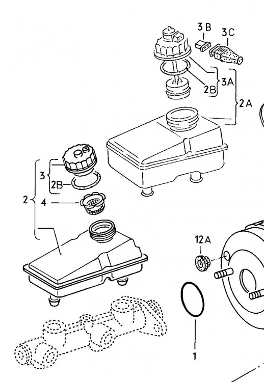

Got me a part 2a (a 321611307B reservoir with fluid level sensor) attached to the ATE master cylinder (dotted lines). Want to replace the part 2.
How do I pull the two apart?
The outlets of the reservoir are in rubber bungs but it doesn't want to come out.
Being careful as it is 23 year old plastic.

are you asking how the res comes off? just pulls upwards
Yeah, literally, just pull/wiggle and pull, it's only the O-rings that hold it in.
Thanks guys. it's apart.
Tried my hands, a big screwdriver, a barbecue fork and finally a vice and a 20 inch tyre lever - pop.
Though I suspect the breakthrough was taking the cap off - think I was just creating suction against the rod in the cylinder.

Anyway good news - hole spacing 85mm centre to centre. It will fit. If I can get the old one out :-)

  • removed the inner filter insert with needle nose pliers
  • siphoned fluid out with hand primed pump siphon tube
  • popped reservoir out with tyre lever into an old washing up tub
  • changed it over - refilled with new fluid
  • watered down engine compartment and driveway
