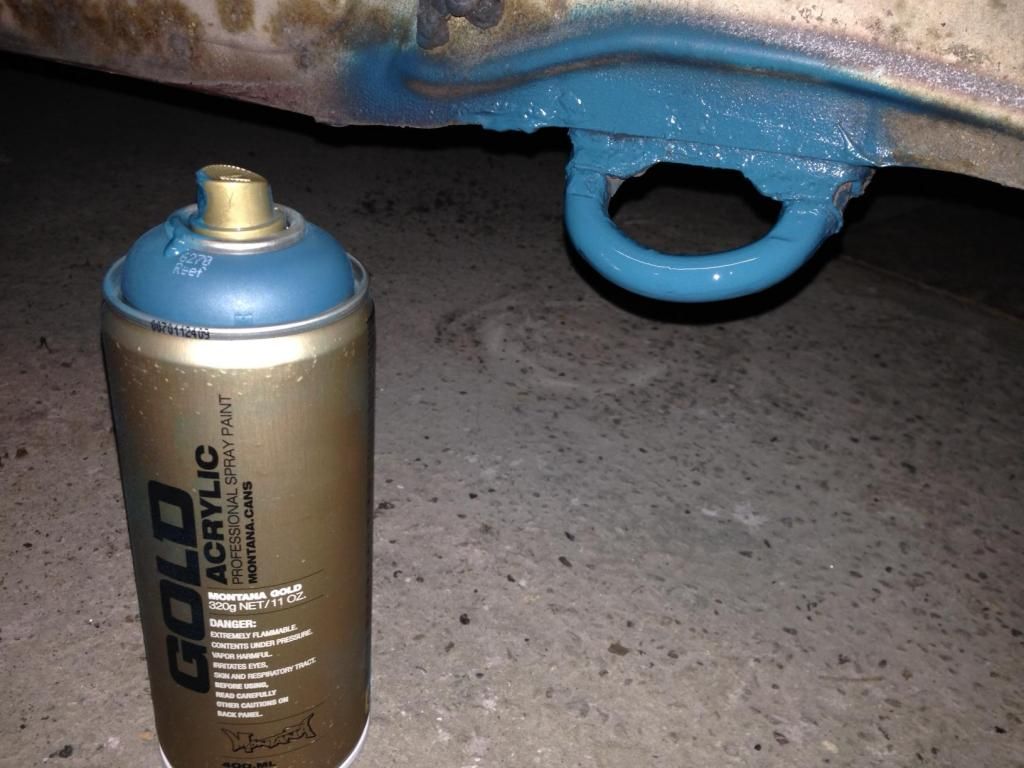

So, me and a mate got cracking a few days ago:
There he is, pretending to help:
Picked up a couple of new front wings from a nice lad on here (buzzin, cheers mate)
There were a few dings in them but got then sanded and filled nicely, ready for this:

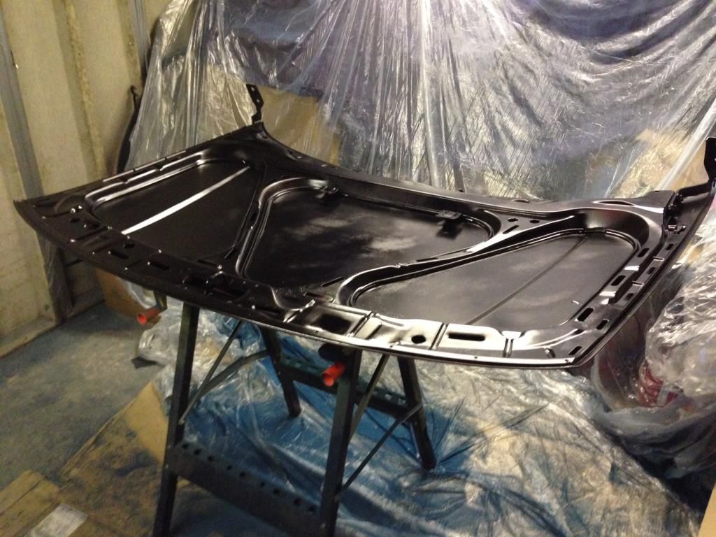

Also got round to putting some paint on the bonnet:
Edited by BoWzER

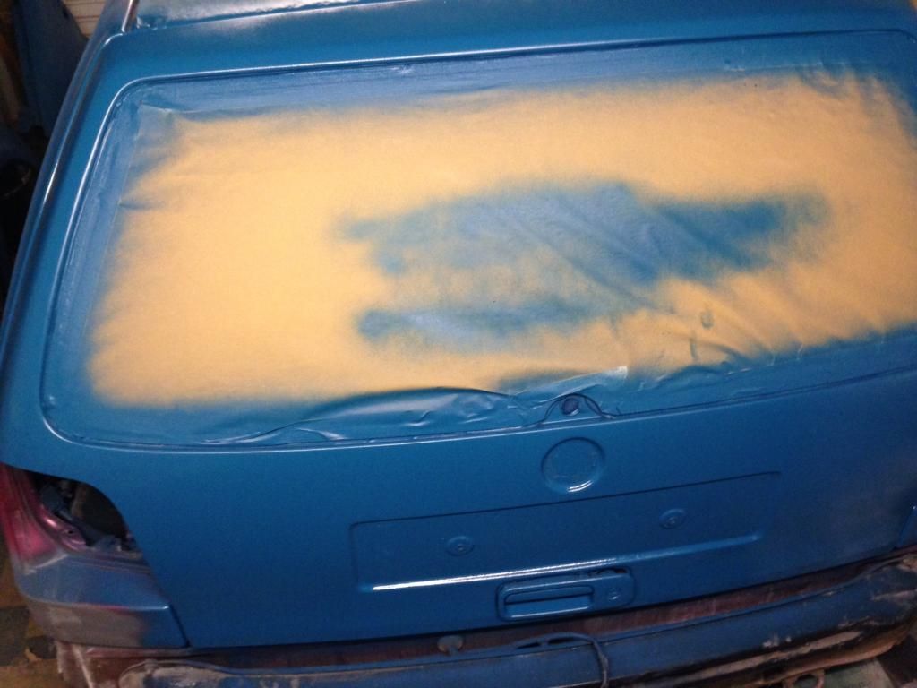

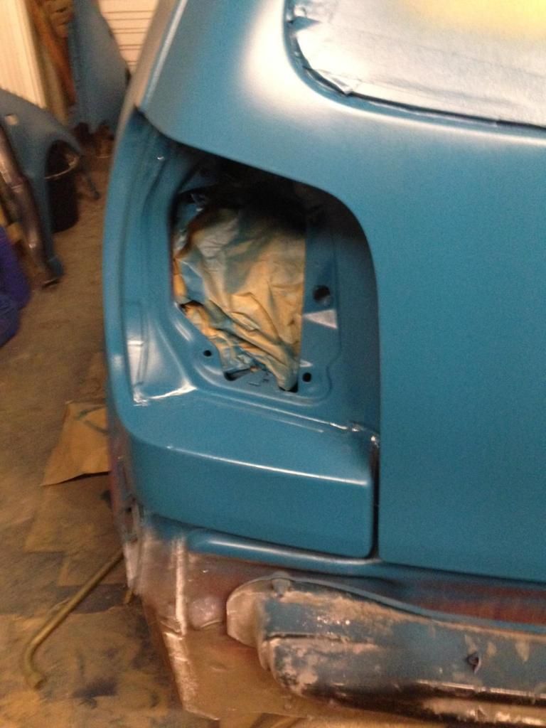

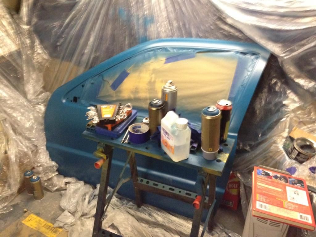

Finished work last night and went straight back down to the garage....paint on the roof came out wank so sanded this down again and gave it another coat.
Set about filling the water channels below the rear lights and a little dent on the bootlid, then got it all masked up ready to paint.
Bootlid and rear quarter got a few coats.
Once that was done, had some of Yorkshire's finest and then pissed off home.
Hopefully get the rest of the body painted up over the weekend, can then start putting her back together.

Love the colour,how many cans did it take to do it
Used about 13 cans of colour, was cutting it close thought tbh.
If you plan to do it i'd recommend 15-20 cans, and set aside LOTS of time!
Looks really good now its back together, could you tell me about spraying the bumpers? Got some 16v and wanted to know the best way to do it, there currently blue, want to get them to white
Cheers man, it's quite easy to be honest, just take your time with them.
Make sure you sand them down plenty, should be no shiny bits by the time you're done. (no need to take all the colour layer off)
Give it a good wipe down with some panel wipe/wipes to get all the crap off before you paint.
Make sure you've got a nice warm/dry space to do it in.
If you're doing them using cans and you've never painted before I'd watch a few YouTube videos to learn the technique and practice on an old panel or something first.
