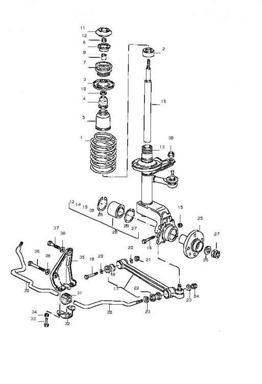

My 1991 coupe GT just failed its MoT. Lower joint on front drivers side wheel bearing housing. Number 13 on the diagram. Help please. Let me know if you have one to offer. Cost and post paid as soon as possible. Joint on the pinch bolt gone.

what exactly failed? was it damaged? seams extremely odd for that to fail
It was the lower ball joint on the pinch bolt. The car dropped into an open manhole years ago when the weather had been particularly wet. Damaged a rim, tyre and upper ball joint. Must have been a left over from that incident. Just picked the car up today. Cost me £80 for the labour to put used parts on the car. Took a lot of fiddling to make it fit apparently. Airvolks in Blackwood did another superb job for me. Thanks to Gareth and Mark.
