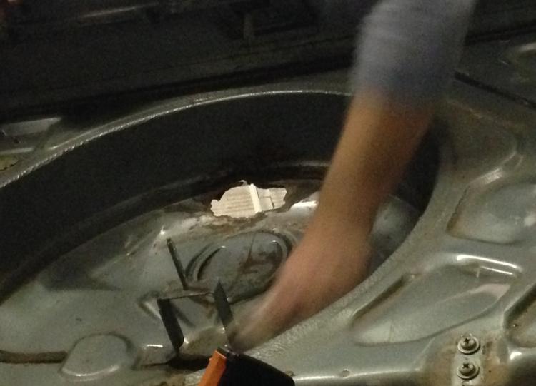

I intend to do some chopping out rust and welding new panel pieces in to repair some bits of my polo but i have a question.
What steel should i use and what gauge do i need?
cheers in advance
Ollie
oh and i thought I'd show the extend of the rust :( (in the picture)

thats prob 1 -1.2mm mild steel
so if thats 1 - 1.2 mild? what would other panels be? rear valance, door skin?
maybe i was being stupid enough to assume most the panels where same
I would use 1mm for rear valance and 1mm for door skin but could probably use 0.8 for the door

outer panels like the bodywork maybe 0.8 mm
doubt theres much thats thicker than 1.2mm on em , if its a structual part best have a good look to be sure , spare wheel isnt structual tho

Nothing other than main rails would be over 1mm,
Go to your motor factors and buy some sheet mild .7mm and you will be fine,
Oh and cut that spare well out and blank it out completely.
with cutting the wheel well out, why do you think i should do that? is it likely to cause me more problems in the future?
In my opinion I would leave the spare wheel well there, otherwise you'll have a spare wheel in the boot all the time lol
Its a hell of a lot more work to cut the whole well out, prep all the area, weld all round it, not to mention the extra expense of the gas and steel,
When you could just cut that small bit out and put a small patch in
