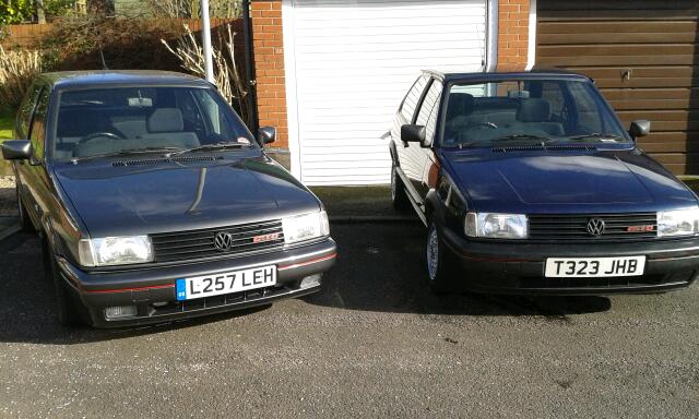

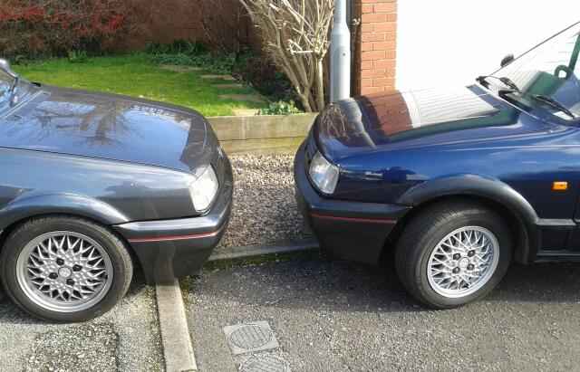

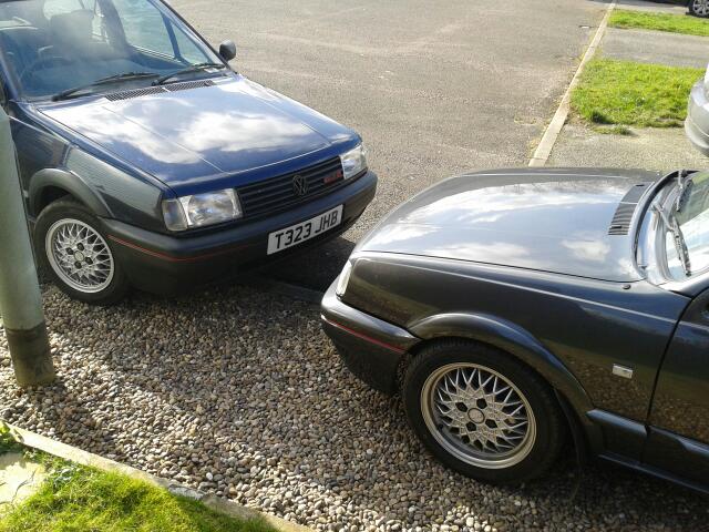

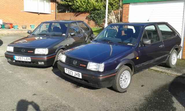

Blue met grey today for the first time - first nice dry day for a good while! Really enjoyed doing some miles in both cars.
