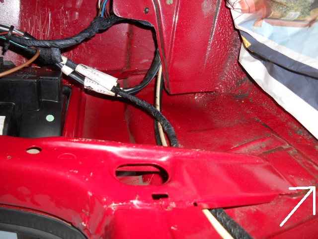

Hi all, I've got a leak in the left side of my boot. I chucked a load of water over it and it doesn't seem to be the light. I've traced the water back to a certain point in the boot but beyond this point i'm not so sure where it's coming from. The rubber seal looks in decent condition and doesn't come away from the metal anywhere so i'm not convinced that's the issue plus i don't see any water coming from it. Thinking maybe the furthest left top bumper screw hole but really i have no idea. I took some pictures and wondered if anyone has had water coming from the same place and where the problem spot was. It's a mk2f.
The first picture shows the bit of metal unerneath the left corner of the boot opening and second shows the flap of metal that sits underneath it and the water seems to be coming from under that flap of metal, can't find where it's coming from beyong there.

Bit of a revival this eh. But yes, the car appears to of had a rear end crash at some point and it's made a tiny split behind the rear bumper where two bits of metal join. Put some sealent on it which worked up untill a week ago oddly enough and now it's leaking again . . . yay . . . So welding time i think.
