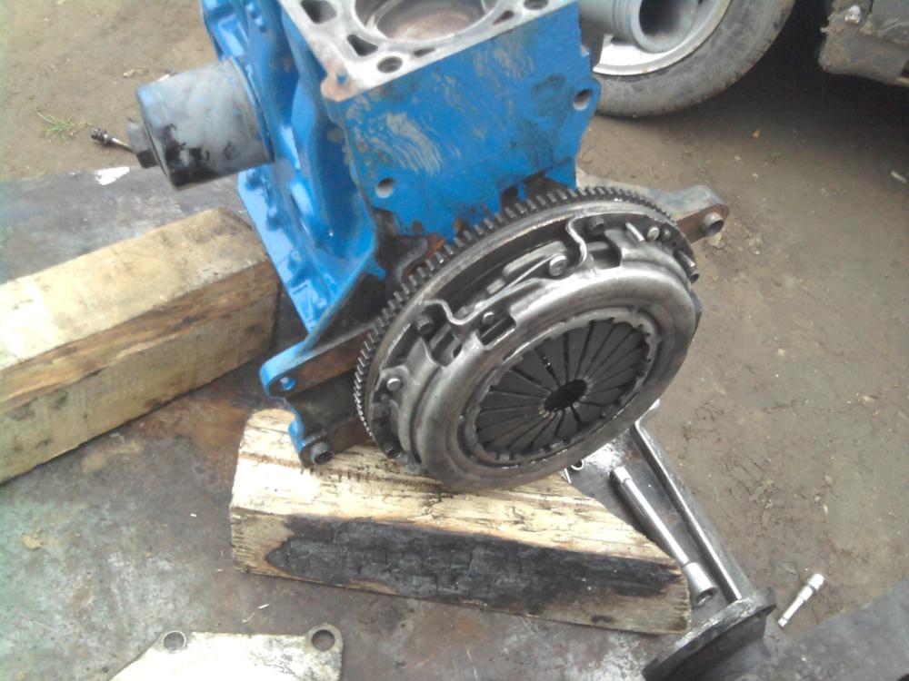

Hey guys. Started doing the conversion, got the 1.3 engine out and started building the 1.6 up. So, the 1.6 is an AEE and the 1.3 is a 3F with a 5sp 085 trans. My dilemma is...the 085 box will not fit the AEE block. Only two bolt holes line up and one of the drive shafts won't clear the oil pan. Where did I go wrong?
You have got a small block AEE havnt you?
Think so, I didn't know there was also a tall block AEE. How can I tell if it's a small block vs a big block?
Anyone?...
Is the AEE that I've got a tall block? I think when I got it a 020 gearbox was attached to it, can't really remember as I got it with two other engines.
Sounds like you have the AEE from a mk3 golf which has a different bellhousing , get a pic up of the bellhousing area
Now I'm pretty sure it's the wrong engine. Guess I'll have to use it with the mk3 golf gearbox

If it's anything like the skoda version, there's an adapter plate that bolts between the block and the bellhousing.
