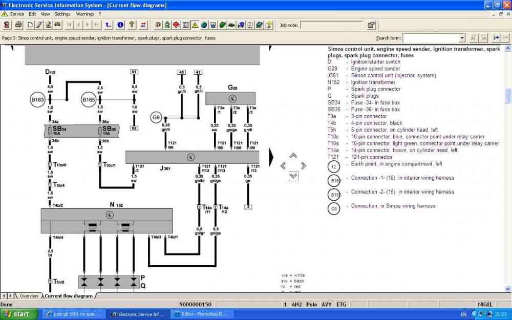

  • Here's the wiring diagram for the coilpack

I am unsure of what the wires are as do not have access to wiring diagrams and haynes manual does not cover the 6n2 gti.

Many thanks very helpful
