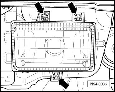

  • You need to remove the just the lower part of the bumper, but it might be easier to remove the whole bumper rather than trying to split the two sections Vehicles with small bumper
Vehicles with small bumper Removing: – Switch off ignition and all electrical consumers and remove ignition key. – Remove skirt → (Lower part of bumper) – Remove securing bolts -arrows-. – Pull fog light housing out of bumper and disconnect connector. Installing: Installation is carried out in the reverse order. When installing observe the following: – Check fog light settings and adjust if necessary – Check function of headlight.
post-36925-0-45476800-1392037307_thumb.p
Thanks for the tip!
