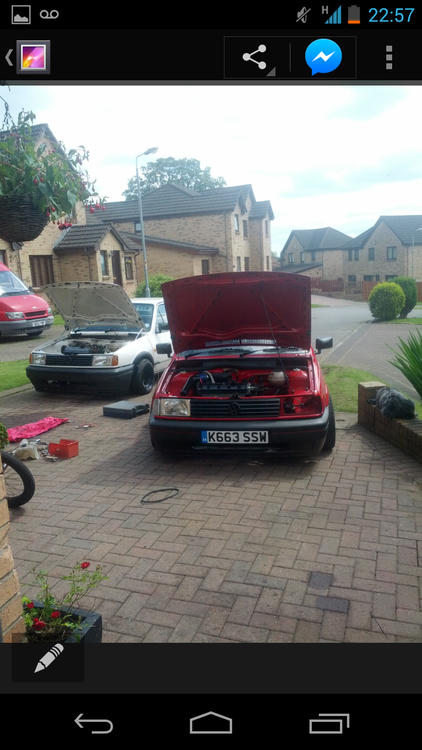

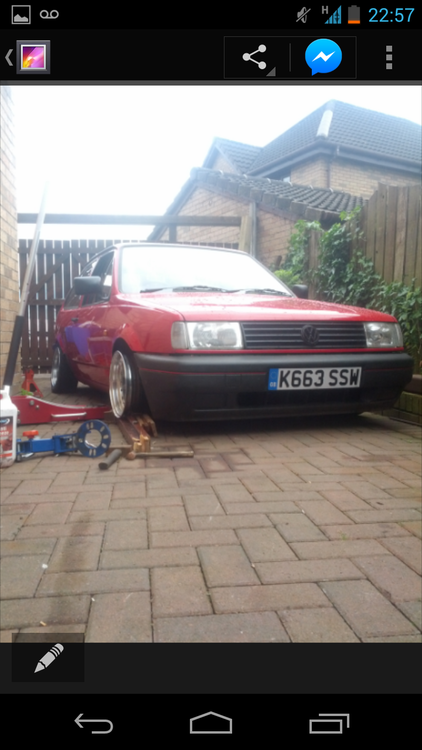

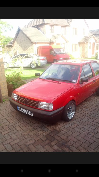

As you guys can probably tell i havn't been on here in a while!!
But basically since I've got the car back on the road I've been to busy sorting out all the small things and having too much fun driving to be bothered uploading any pictures,
i was planning on making this a proper build thread and adding a photo or two every time i done something new but to be fair I've been far to busy so i felt i should just upload all the photos I've got and if you guys have any questions then feel free to ask :)
basically over the past few months I've been having problems with my splits leaking, tyres blowing out, driveshaft problems and I've needed to replace the front left wheel bearing twice because I'm daft and forgot to put the thrust washer back in !!!!
Apart from a new wheel bearing and a new drive shaft the only other thing i think I've done is add a solid gearbox mount and raised the engine about 10mm (still to be raised more once I've had a chassis notch)
but anyway here is how she looks these days and ill try keep my posts upto date from now on :D
