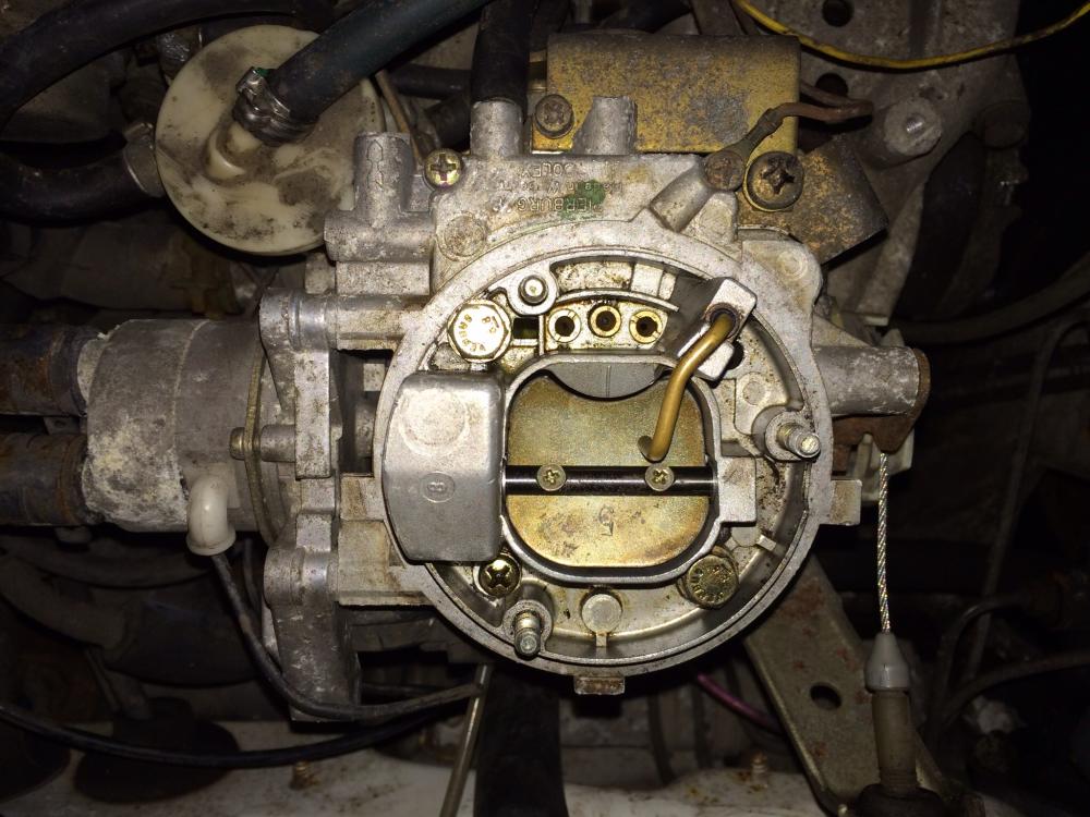

Take your air filter lid off and take a photo of the carb,
If you are unsure how just unclip the lid lift it off and you should see two or three 10mm nuts/bolts unscrew these and prise the filter base of there may well be a couple of hoses holding it back just lift the filter base to one side and take the pic,

This pic any good

Yep pretty sure I have one reach under the manifold and you will feel four 10mm nuts unscrew these (put a sheet or a large piece of card under the car firstt just incase you drop one ) and the carb will lift off,
You should be able to lift off the carb and remove the base without disconnecting any fuel lines cables etc.

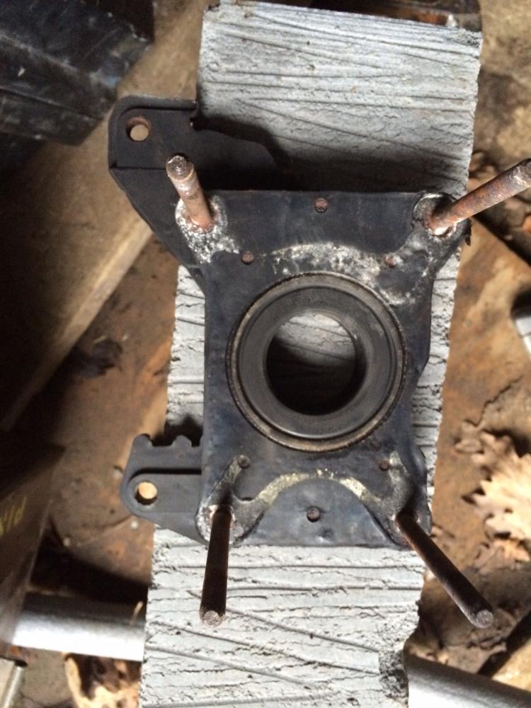

This one
post-915523-0-11915800-1394124708_thumb.
Is it perished and the rubber peeling away from the metal?
This is the one I have notice the bolt holes for the carb.

Doesn't look the same yeah it's split between metal and rubber
You can make a temporary repair with sikaflex or a butyl based sealer.
Have your Chassis number ready and phone a VW dealer parts dept, and although it is probably discontinued they should still be able to give you the part number then you can contact http://www.volkswagen-classicparts.de/ via Google translate if your not fluent in German.

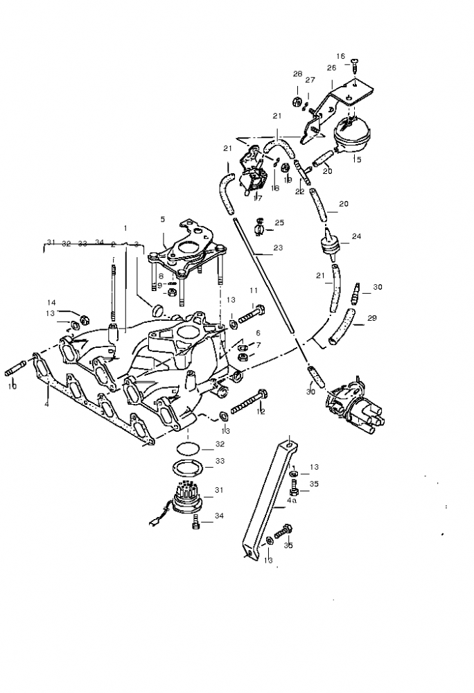

Hi guys a new problem has now happened after replacing the rubber manifold within 200 miles the captive nuts had come out of it so I thought it was a faulty one replace it and the same has happened again can anyone help?
It does look like there's a bracket missing which goes from the engine to the manifold
There's a support bracket part 052129723D. between block and inlet manifold.
Any flex would give leakage at cylinder head surely?
http://www.vagcat.com/epc/cat/vw/PO/1985/9/49/145843/
(you'll have to sign up to see vagcat)
post-3301-0-64404300-1424531955_thumb.pn
Mine's not had a bolt (M8x18) attaching to engine block for 5+ years so I don't think it is actually needed.
