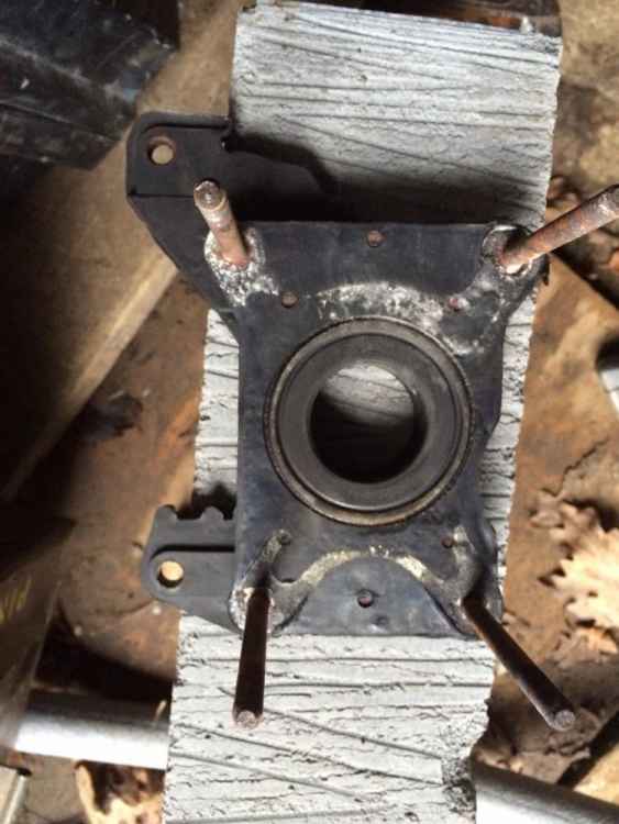

  • Rubber carb base is split/rotten allowing air in upsetting the mixture.
  • Is it perished and the rubber peeling away from the metal? This is the one I have notice the bolt holes for the carb.

I've spoke to GSF and they're sending a replacement is there a torque setting ???
6mm 8.8 bolt torque is under 10Nm.
I'd say finger tight so no torch light shines through.

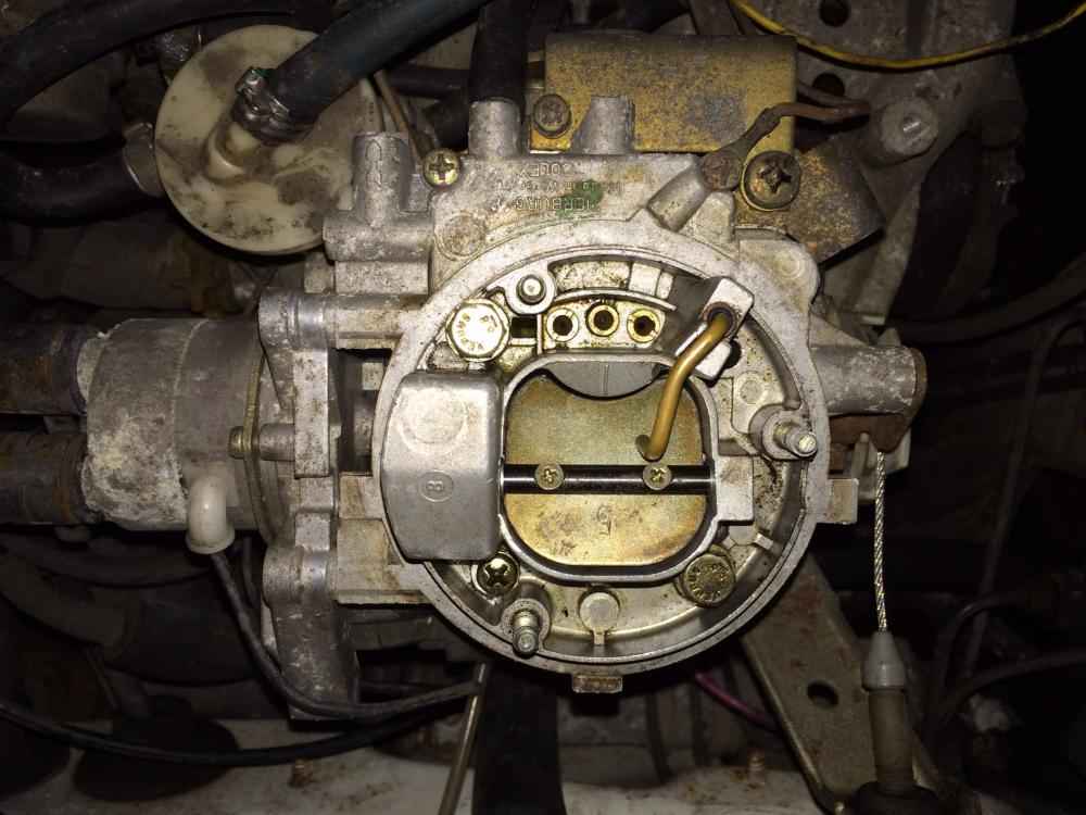

Have you got the big metal bin lid air filter on top of the carb?
