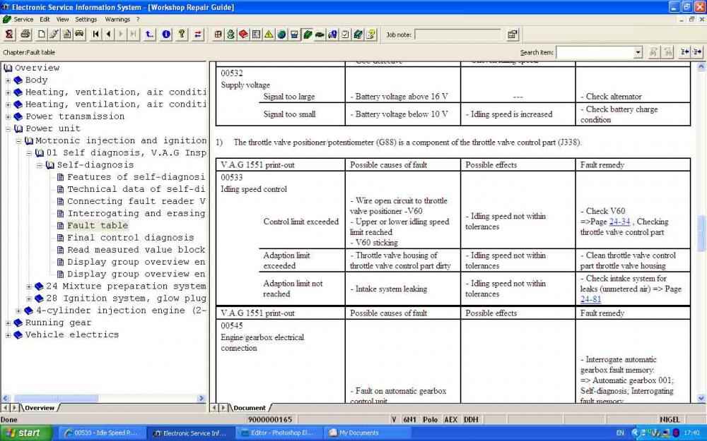

Here's the fault finding for that code
post-36925-0-32709500-1394991159_thumb.j

thanks for the info, it shows adaptation limit exceeded and reached but not surpassed are they all basically the same, would 00533 cause the car not to start? or run on only 2 cylinders?

Surpassed is the same as exceded, but that code would not cause it to run only on two cylinders, I'd be looking more at the ignition side of things, distrubutor cap, leads, plugs etc or could even be the hall sensor in the distributor.
