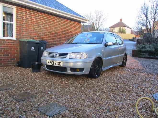

i'm Josh i'm 19 and driving a 6n2 1.4 16v which i bought back in February, it was a bit mechanically ratty when i bought it but after plenty of hard work the mods have started!
post-915715-0-13631100-1395103171_thumb.
As i bought the car!

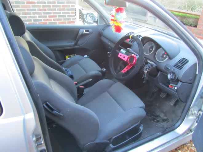

The first mod that was completed by myself was the deep dish Steering wheel and boss which I bought off a pair of brothers, one which had a mentally modded 6n, who had the boss, and one who currently owns a mark 2 Breadvan, who the suede steering wheel is from!

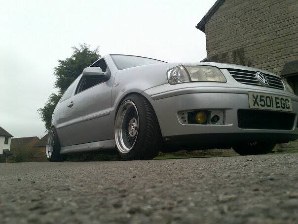

I bought the Klutch SL1 around two weeks ago, i'm currently fitting it with camber bolts (for the front) and camber shims (on the back) for that nicer fitment!

Camber bolts? Da Fuq is that?! Just camber the fronts via the strut.
Welcome along though
how can anyone sell camber bolts for a 6n2 when the camber is adjusted from the standard bolts... they're praying for money there from people who dont know!
loosen the bolts on the strut, push the hub/disc back a bit, tighten and refit until you get the desired level of camber.
