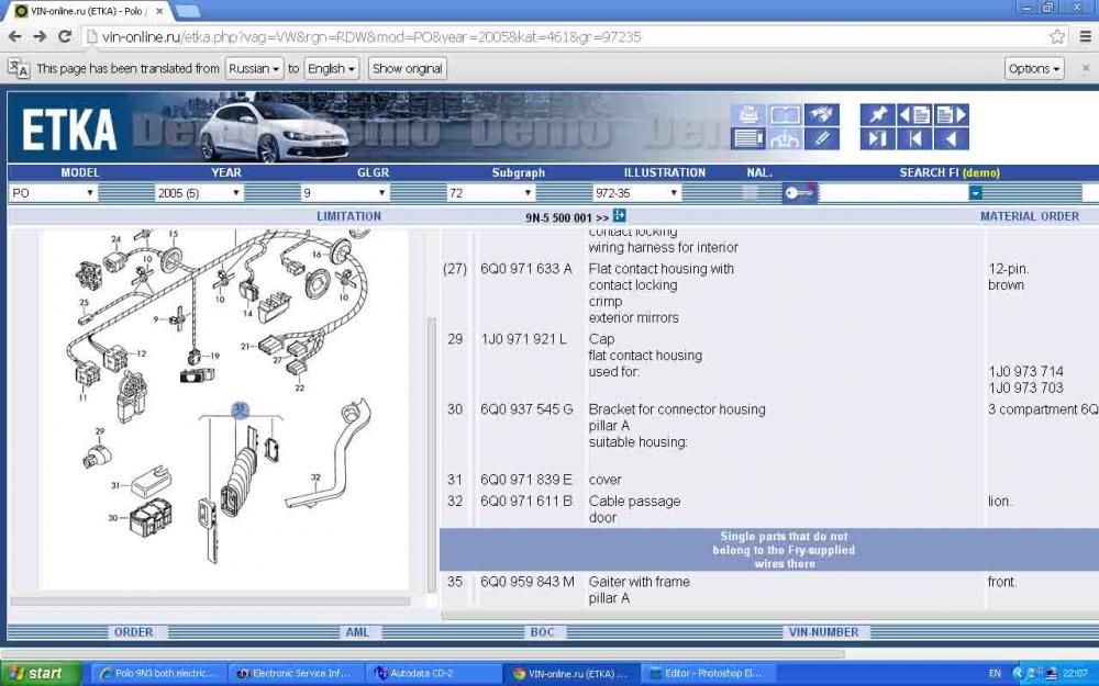

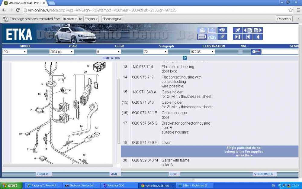

Also does anyone know the Part number for white plastic grommet holder? it's located on the driver side door where the loom connects to the main car loom.
See the white plastic piece there there should be two parts to it, the one shown fits into the bodywork and the other which i need the grommet fits on to. Can someone help me out on this. Thanks in advance

First Welcome to the forum.
As your car is a 2005 it could be either the last of the 9N1's or the first of the 9N3's Are the headlights in one complete unit or two with the bumper cover seperating them?
Assuming it's the 9N3 here's the parts listing

If it's the 9N1 here's the parts listing
post-36925-0-98210300-1395612609_thumb.j
