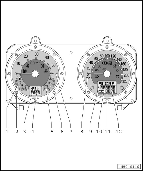

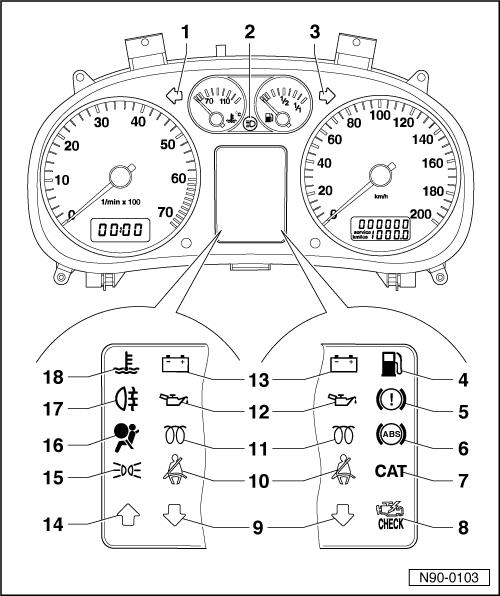

The easiest way to tell the model is the speedo display
This is the 6N1
post-36925-0-26086600-1398375429_thumb.p
This is the 6N2
post-36925-0-48999300-1398375445_thumb.p
Okay that makes sense it is the 6n2
