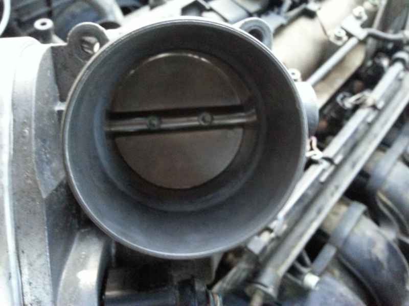

-so I've tried cleaning the throttle body using a guide from this forum with a carb cleaner. this thing was full of shit. never had it cleaned since i owned the car back in 2005. here is a picture of it at the 5th wash. half the carb cleaner is gone.

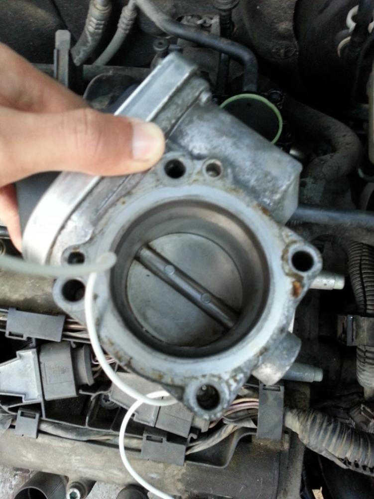

some local shop here told me to try oven cleaner foams. it works faster and makes all those solid black bits of oil and fuel gewy and easier to clean. so now it looks like this

The throttle body certainly LOOKS better!
The thought just crossed my mind that I hope you didn't get any of the oven cleaner inside the electrical part of the throttle body.

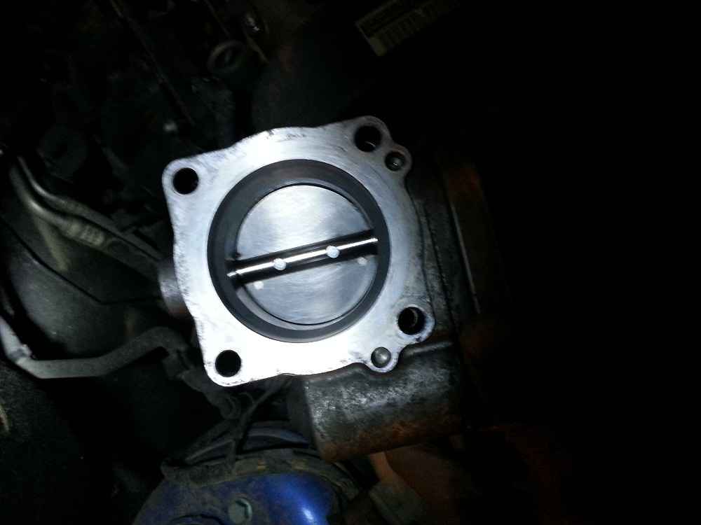

so I've changed the temp sender. things look a bit more steady but not yet enough. the throuttle body still refuses to respond. a friend of mind told me to clean the air sensor in the throttle body. i cant see to find something like that, any one can reference me? I've uploaded pictures of the upper and lower side of the body plus the intake under it.post-917431-0-32920400-1407512801_thumb.

when i was looking for the air sensor on the throttle body, i found that the body's ecu plug was full of oil. where did the oil come from? using the oven cleaner, it leaves a bit of oily lubricant if yiu dont clean it with a peice of cloth or so. so i went and got my self a contact cleaner spray full of alcohol apparently. did a good job and now pressing the paddle works !

i should have listened to Caretakerplus when he told me off about the oven cleaner and the electric parts =(
ok so this car's problem is officially solved. you guys were right, i needed that plug and vagcom software to align the throttle body. i went to a local shop with a young man thats been working for the dealer for 10 years. he says all the steps that I've done so far were good and make sense, only i didn not align the throttle body with VAGCOM so i owe you all that. with a couple of diagnostics, he claims that other shops were trying to rip me off saying the engine has only 3 cylinders working and it needs a while new engine. the car is way better but its shaky a bit so we ran a few tests, checked a couple of places behind the engine and discovered a small crack in the intake manifold i made by mistake one day when i was changing spark plugs and dropped a wrench or something. the crack is soooooo small i can barely believe its causing any air leakage. so we tested an old manifold he has on his polo and every thing went fine.
