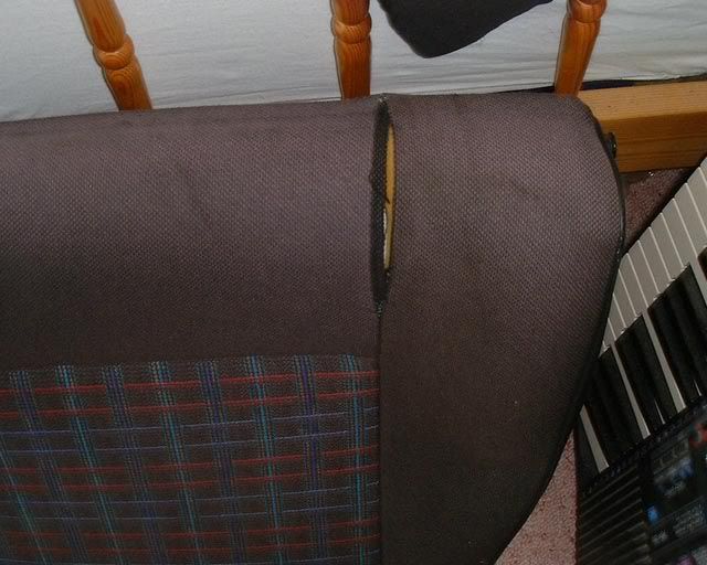

OK in the first part of this guide we're going to turn this faded, ripped rear bench backrest:
Into this nice black, unripped one!
First of all to repair the rips we need to take the cover off. This is done by just pulling the fabric away from the metal around the edges:
Do this all the way round until you can peel it back to reveal the yellow foam inside. There are clips placed around the edge which hold it on but these also just pull off, requiring a bit more effort. It can be a bit hard to get the first part off but once you have it's alot easier to remove the rest.
Once you have removed the fabric from all the way round, the metal back of the seat will come away, and you can peel the fabric back so far. It's held to the foam with stiff, strong metal wires which follow the seams on the inside.
Undo all of these and you will be able to remove the seat cover completely:
From here it's just a case of sewing up the seams on the inside with strong thread, you can just follow the original holes!
Once sewn up you will have something like this:

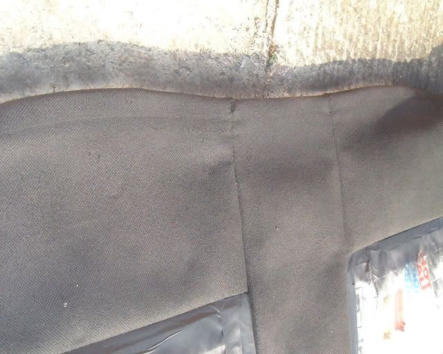

Now onto the dying! I used VHT Black Satin Penetrating Colour Dye for vinyl and short nap carpets, bought from USAutomotive.com here. Obviously you may wish to use a different colour to match your seats/interior. To give you an idea of how much you might need, with one can I managed the following: The rear bench backrest, two mk3 coupe rear door cards and one front door card.
Mask off the patterned bits (if you want to, you could dye these black too although I'm not sure of the results) and spray! DO use long, even strokes and DO use in a very well ventilated area! Try to avoid a windy outdoor location like I had though, half of my spray probably went all over me! From my experience I wouldn't bother with their recommended 10-12 inches spraying distance, half that was what I did, but then I am useless with a spray can and it was windy.
Now it's a case of leaving it to dry for a day and putting the cover back on. Refitting is a reversal of removal, make sure you get all the metal wires in first, then begin to reattach the edges, remembering to refit any of the metal clips that may have come off when you were removing it.
