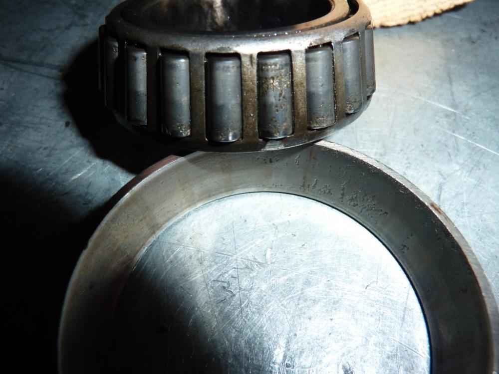

Advice was that these boxes are fragile with the diesels so well worth checking the condition before fitting. I first took the 5th gear cover off, which revealed some fine shrapnel and some endfloat in the mainshaft. I then went one to split the casing and that revealed that the "usual suspect" mainshaft bearing was a bit past it's best

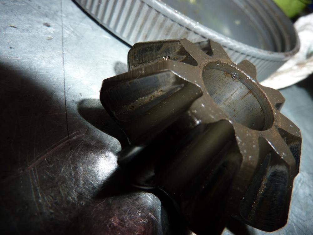

and also that the diff planet gears were deeply pitted causing concern about complete failure in the near future

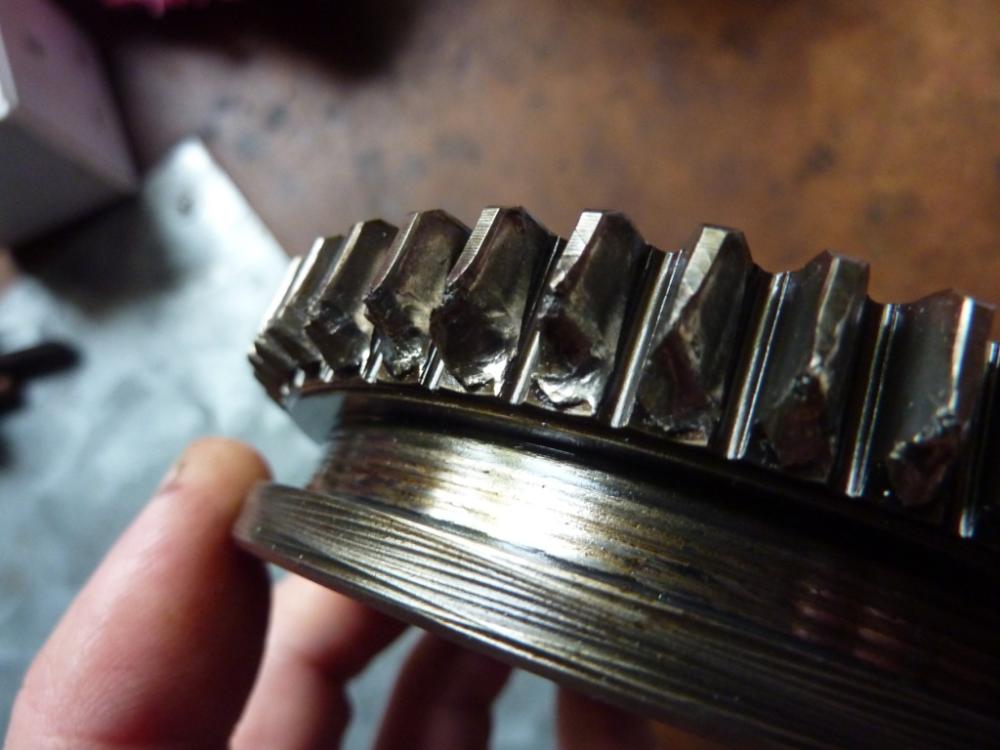

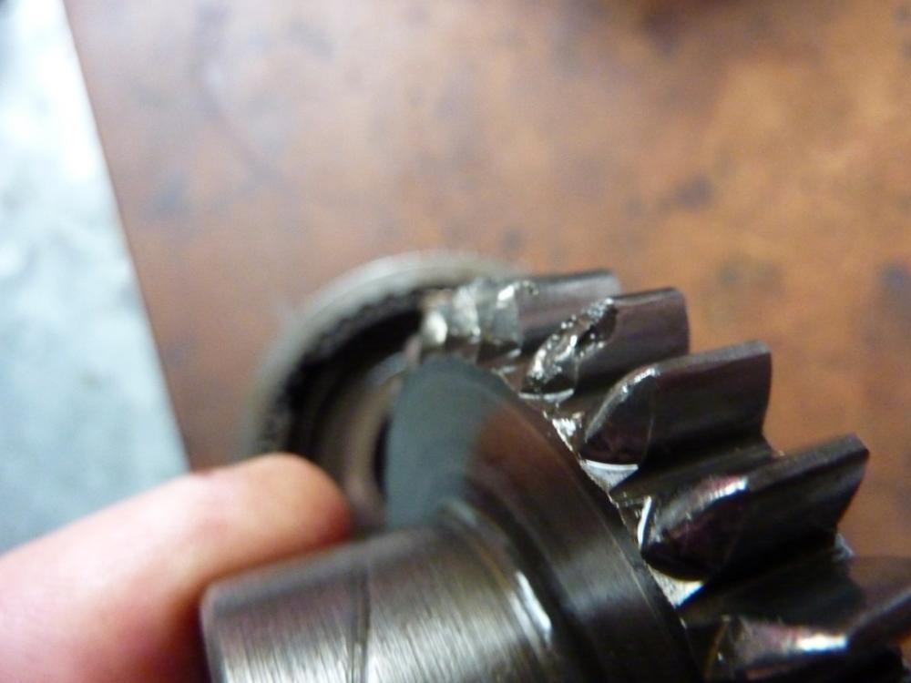

Having got it all apart the good news was that most parts were ok and no teeth on the input shaft or mainshaft themselves were damaged. The bad news was that reverse gear was well chewed.
post-917575-0-52068500-1409258256_thumb.
post-917575-0-98829900-1409258299_thumb.
Oh poo.......

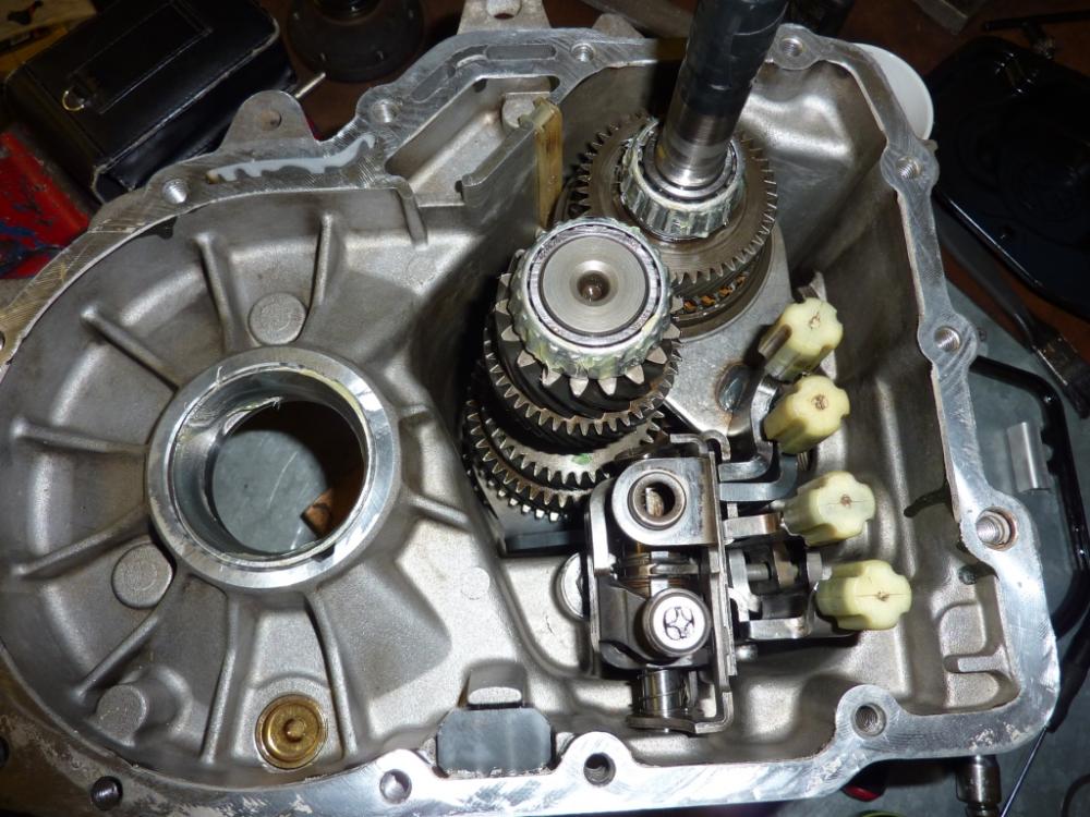

post-917575-0-30807100-1409258535_thumb.
and we then had the fun task of wrestling the old box out and the new one in on Sunday. Checked out the clutch along the way, which turned out to be just about down to the rivets. Luckily I had invested in a new friction plate, though for some reason the splined boss in the centre was 5mm thicker than the old one on the flywheel side, which meant it had to have a tickle from Mr Grinder before it would fit. (yes this is the bush mechanics workshop!)
Happily everything works as it should. All forward gears engage sweetly and run quietly. Reverse sounds like reverse and the correct ratios transform the car. 70mph at 2550 rpm now. As a bonus the clutch action is now much lighter.
