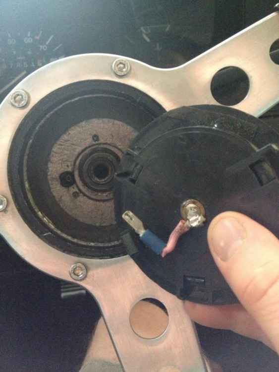

post-914724-0-34917400-1410729924_thumb.

Kay. I just tried wiring this bitch up and it didn't work. I connected the wire from the back of the button, (in the picture above,) to the connection at the base of the boss. (Also in the picture.) If you look real close, you can see a little metal plate at about 8 o'clock on the back of the button. I'm assuming this completes the circuit.
Am i wiring it up correctly?
Have you tried connecting the connection in the boss to ground? this should sound the horn, if you have a multimeter do a continuity test between the wire from the centre of the horn push and the metal contact on the side of the push and when you push the button you should have continuity

I'm assuming that the little bit in the bottom of the boss is meant to create the connection to the chassis. Either that isn't connecting or there's something wrong inside the switch. How would i go about testing the switch and the connection on the boss to see if they even work?

If you short the little tab in the boss to the centre nut, it should sound, if not then the metal finger behind the boss isn't contacting the ring on the boss. Take the wheel off and short the finger to the centre shaft, should go beep.
Also, I'm guessing the wheel has a clear coat over the shiny metal. Might be worth scratching away a little bit on the inside edge where the buttons side contact is as it may not be connecting.
I have seen many of these types of wheel before but this is the first with this type of side contact, I normally see two wires and I have to solder one of them to the boss body. Good idea really
