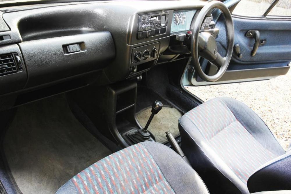

    Here's the GT seats I bought and fitted yesterday morning Think the blue part of seats matches the cl blue carpet and door cards well but I'm undecided on the parcel shelf, also apologies for th

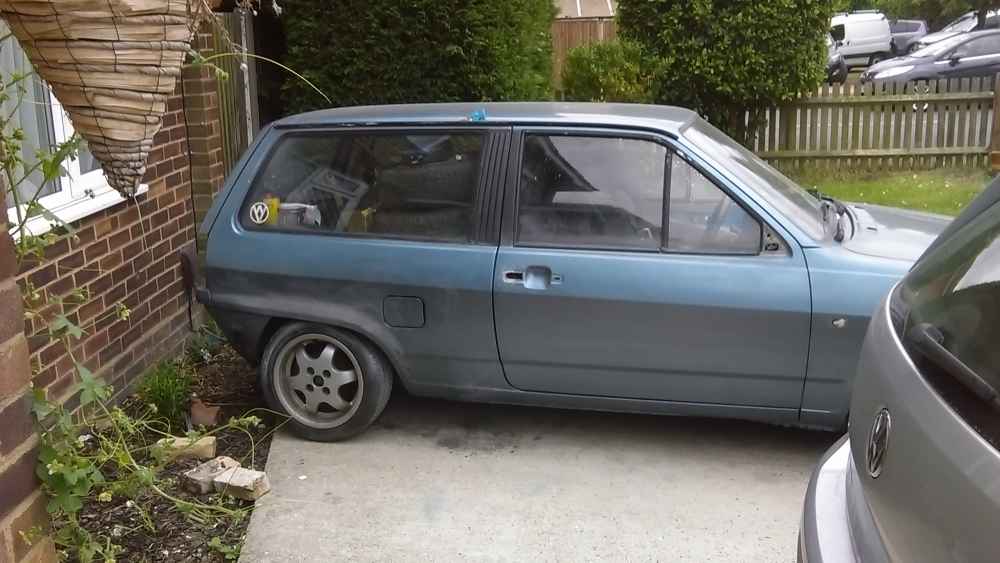

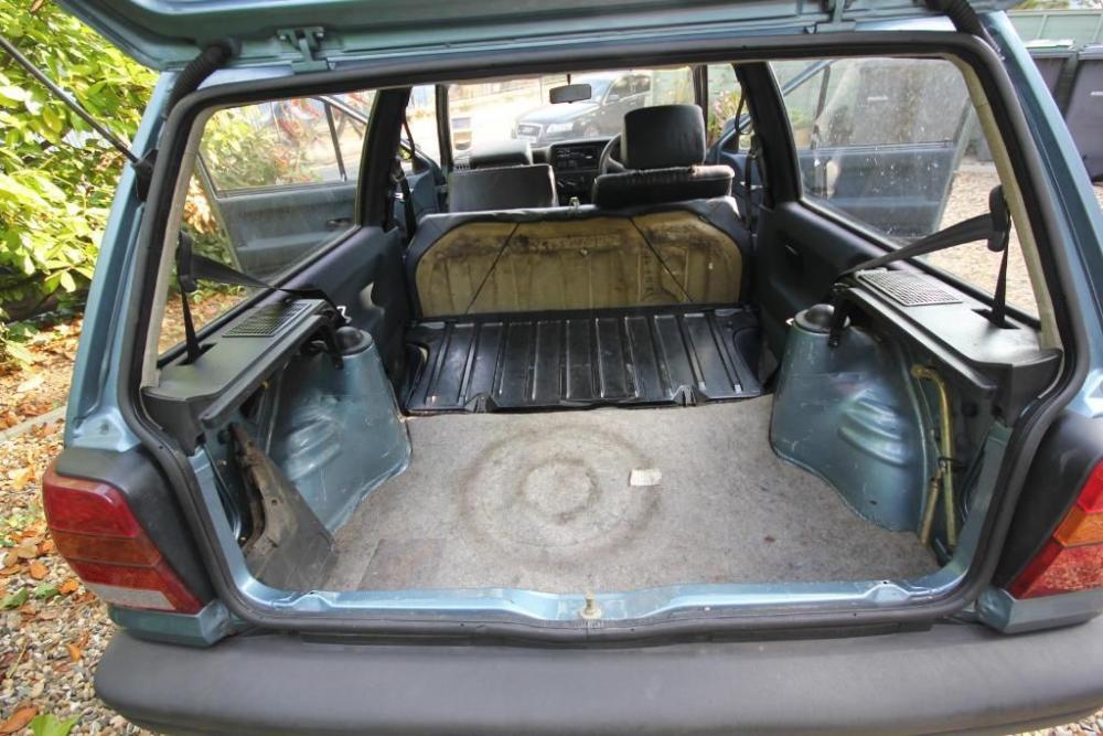

well I got the breadvan back at home today and as predicted there are some setbacks, badpoints are:
three of four arches have small amount of surface rust.
there is a deep scratch which started rusting on near side rear quarter.
small dent below near side rear light started to rust,
good news
for the price, its pretty incredible
the few cosmetic jobs arent exactly eyesores and barely noticeable plus an easy-ish fix
the car was covered in leaves and tree sap and the bumpers where salty as. so i gave a good wash and heat gunned the black bits of trim and bumpers and I'm proud to say that it came out lovely! absolutely buzzing with this car so far and cant wait to get cracking, only bad point is i spunked most my money so i can only do minor jobs for about a month!

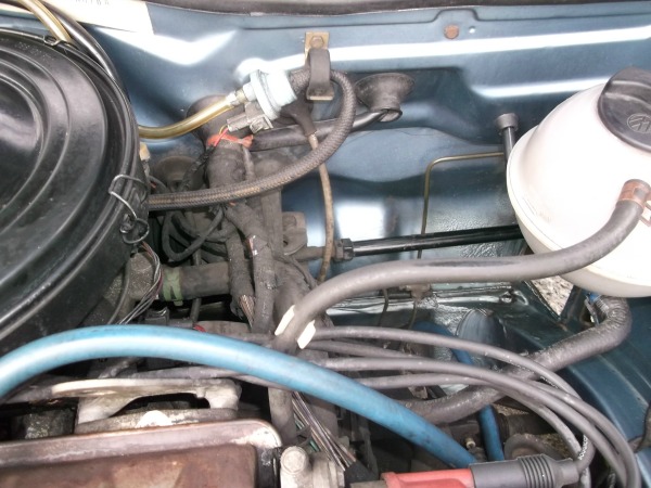

well my engine bay was covered in 1-2mm thick of clotted old oil, and I decided i would check for a present leak just in case there was one, in the end i ended up cleaning the whole bay but not quite finished yet. And good news I've been driving around and no sign of a leak which is good, ill let pics do the talking.
post-918226-0-06397000-1411922344_thumb.
post-918226-0-46343000-1411922575_thumb. post-918226-0-59052600-1411922592_thumb.
there are more bay pictures but this uploader really is absolutely rubbish! say ill upload some of the exterior, I'm midway through treating rust now and also blackened the bumpers with a heat gun. the car was covered in sap when i got it from being under a tree but all clean now apart from the front bumper is a bit dirty after heat gunning from cleaning the bay

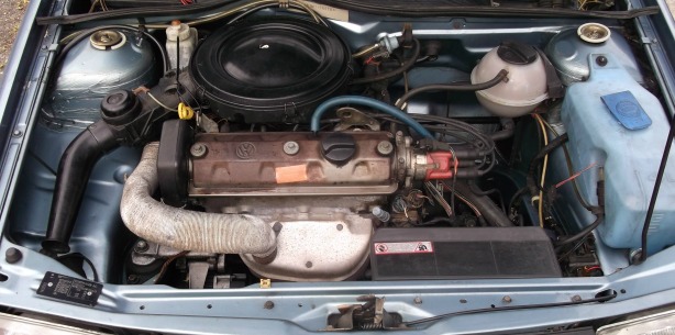

a couple more bay pics as I'm using photobucket now

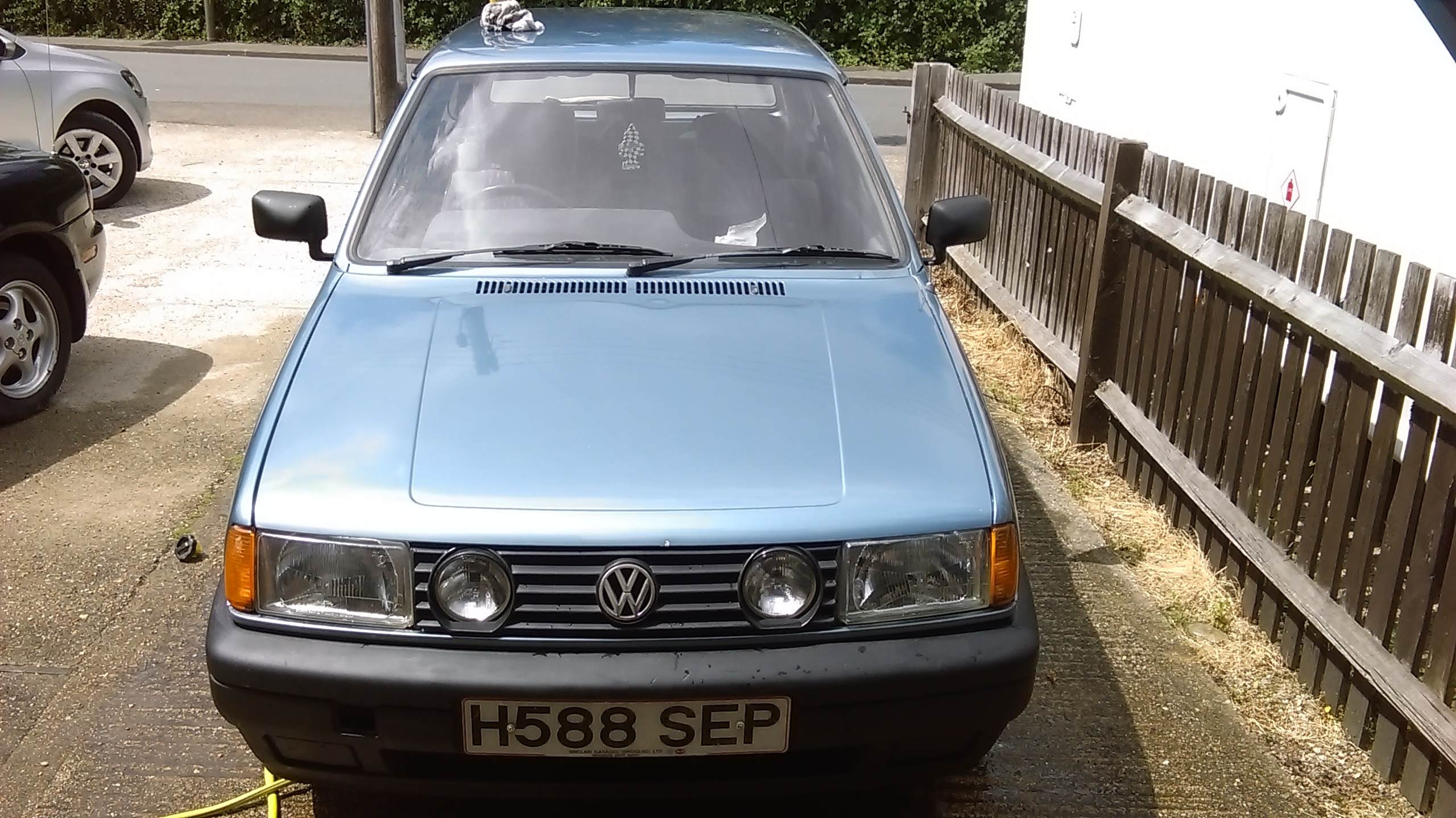

and ill leave you here with a random pic of her from the front

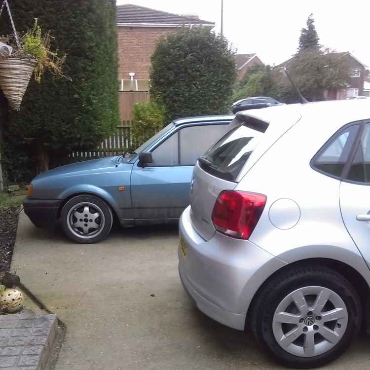

back from the course i done at portsmouth and sorted the front suspension out yesterday and today, nightmare really..couldnt get the castle nut thingy of old struts so had to grind old spring plates and stuff from old shock absorbers...joke. Then i still have the problem now everything is done except I cant tighten the nuts down on track/tie rod ends...
literally tried hammering them up the section that mounts them to the strut and levering them against it but the stud still keeps spinnning with the bloody nut. I'm thinking of blowtorching the fuck out of the nut as its more malleable than the stud and should expand. before i burn by tie rod bushes to fuck though does anybody have any suggestions???

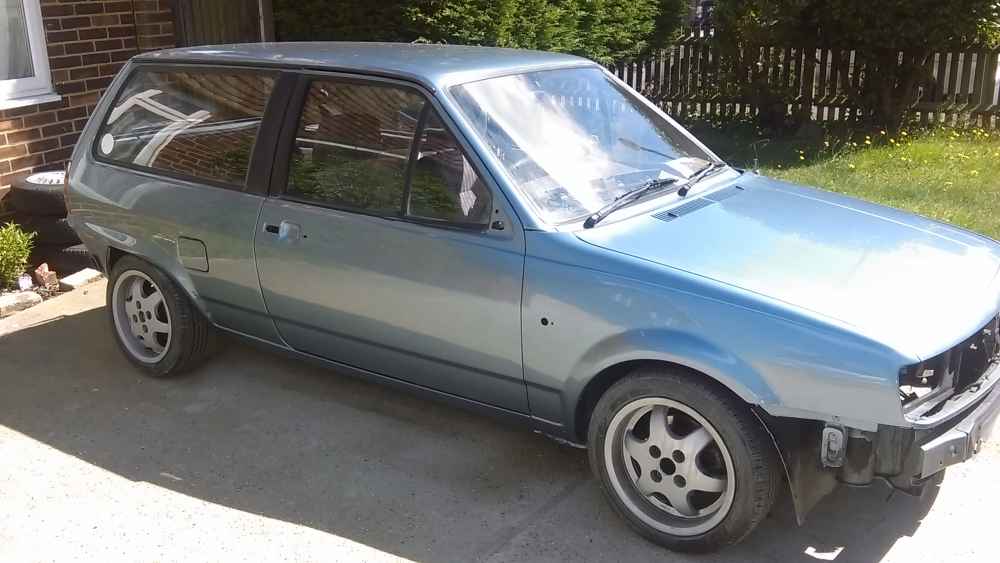

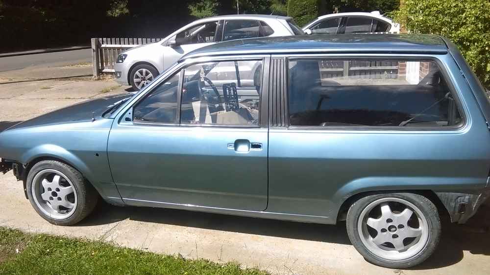

a picture of how low the front is after i was done
and a picture to show that its still very practical even when coming off a sloped drive

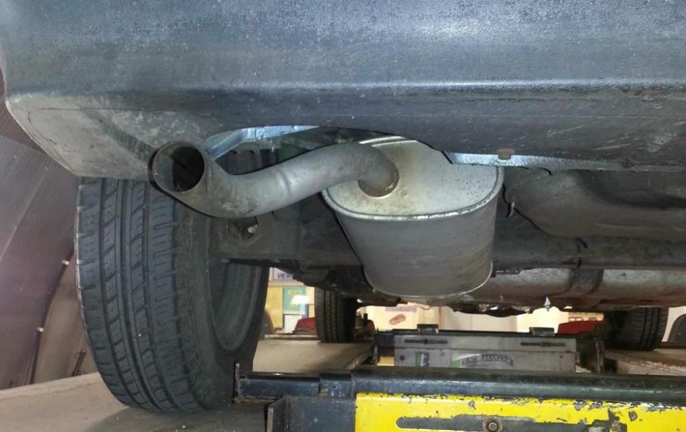

I had a under bumper picture but lost it....theres a good inch of clearance there even off the drive

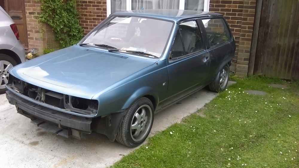

I've started removing stuff today...well i removed the back bumper the numberplate trim and rear lights. front bumper is missing the majority of the bolts and is only held on with one plastic nut from in the bay and then two plastic rivety things in the arch liners...not sure if these pull out? dont want to break anything. Also guessing for the grille i have to prise the clips out except I'm scared I'm going to snap them as they are being stubborn? is there a certain way for the grille to be removed...i really need to buy a haynes,
when everything is removed I'm removing imperfections with an orbital sander primering up and sending her to be sprayed professionally..only both sides and the tailgate but the bonnet and roof may follow if the match is not great. i will just do door shuts myself and maybe the boot space.

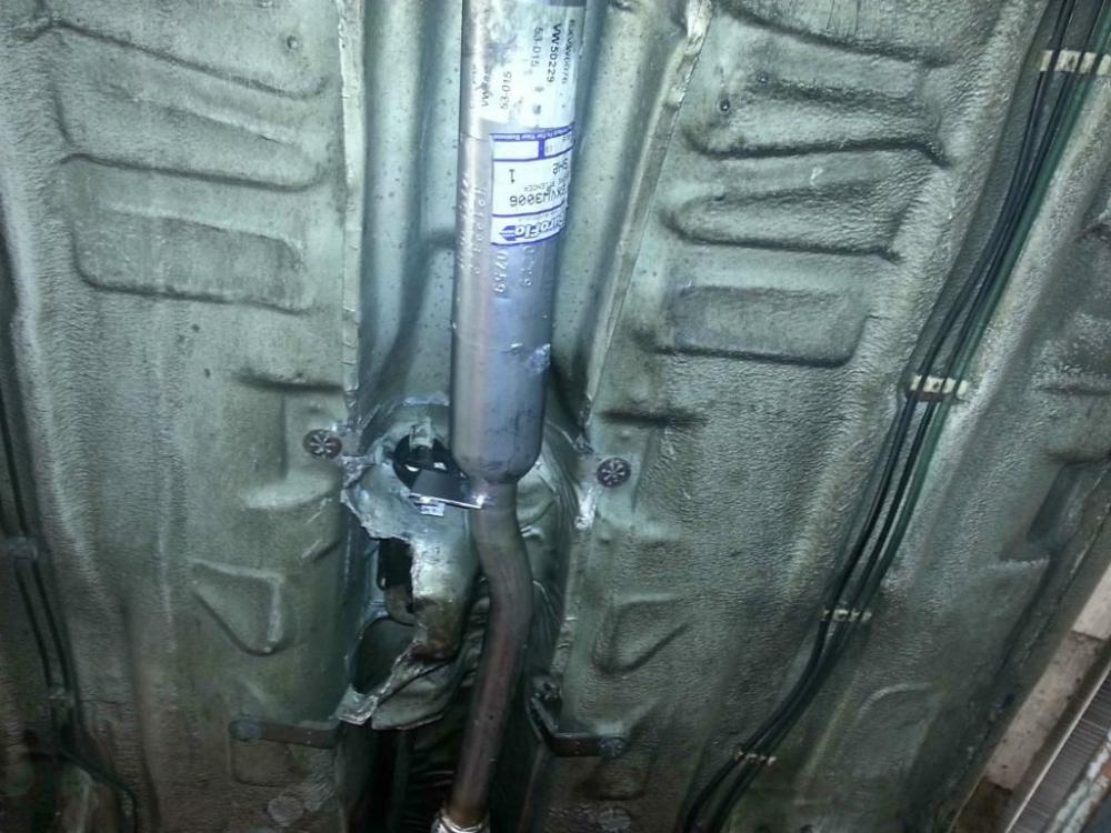

fan problem still exists as I am lazy, sill near tank not welded as i am lazy, non adjustable steering arm not replaced with new one because i am lazy and finally engine thats not needed any more in my boot because I am lazy. <<<(there is actually much more but i am lazy)

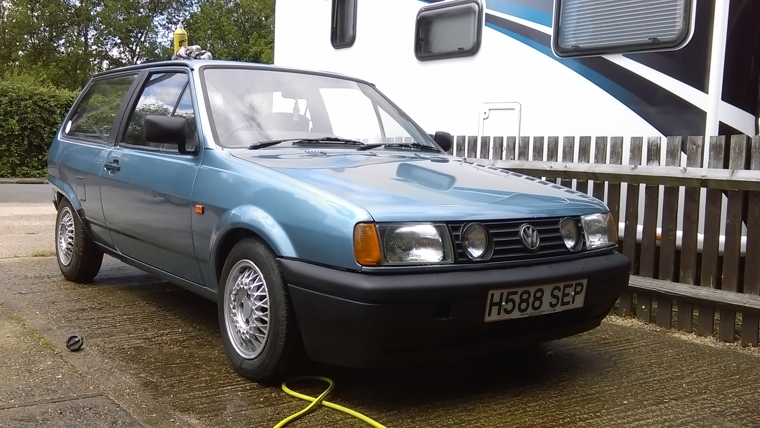

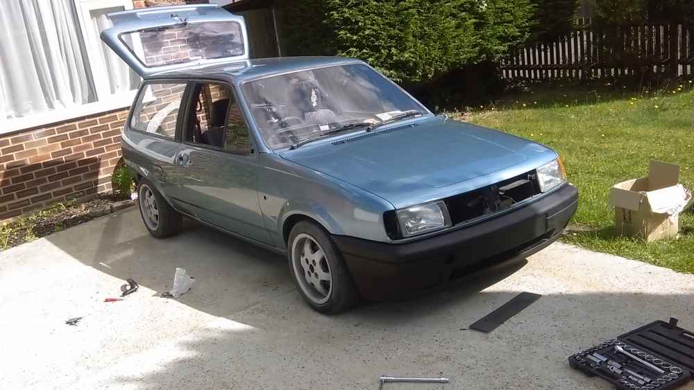

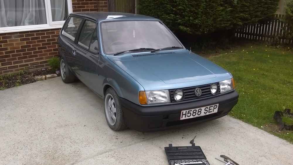

Couple pictures with a test fit of the votex grille I got from kwijibo Steven, looks amazing in my opinion, just need a way to fit the top of the grille to the body before I keep it on and it hasn't been wired in yet
Today I have cleaned and sprayed some exterior trim bits and everything except the boot numberplate light plinth and back bumper is fitted because my boot needs sprayed.
I also got some of the trim bits from retro wheels and I am officially not missing any trim now! Took some pics after a onceover
