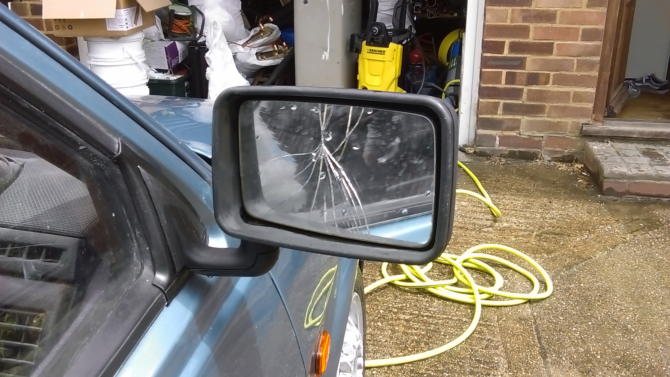

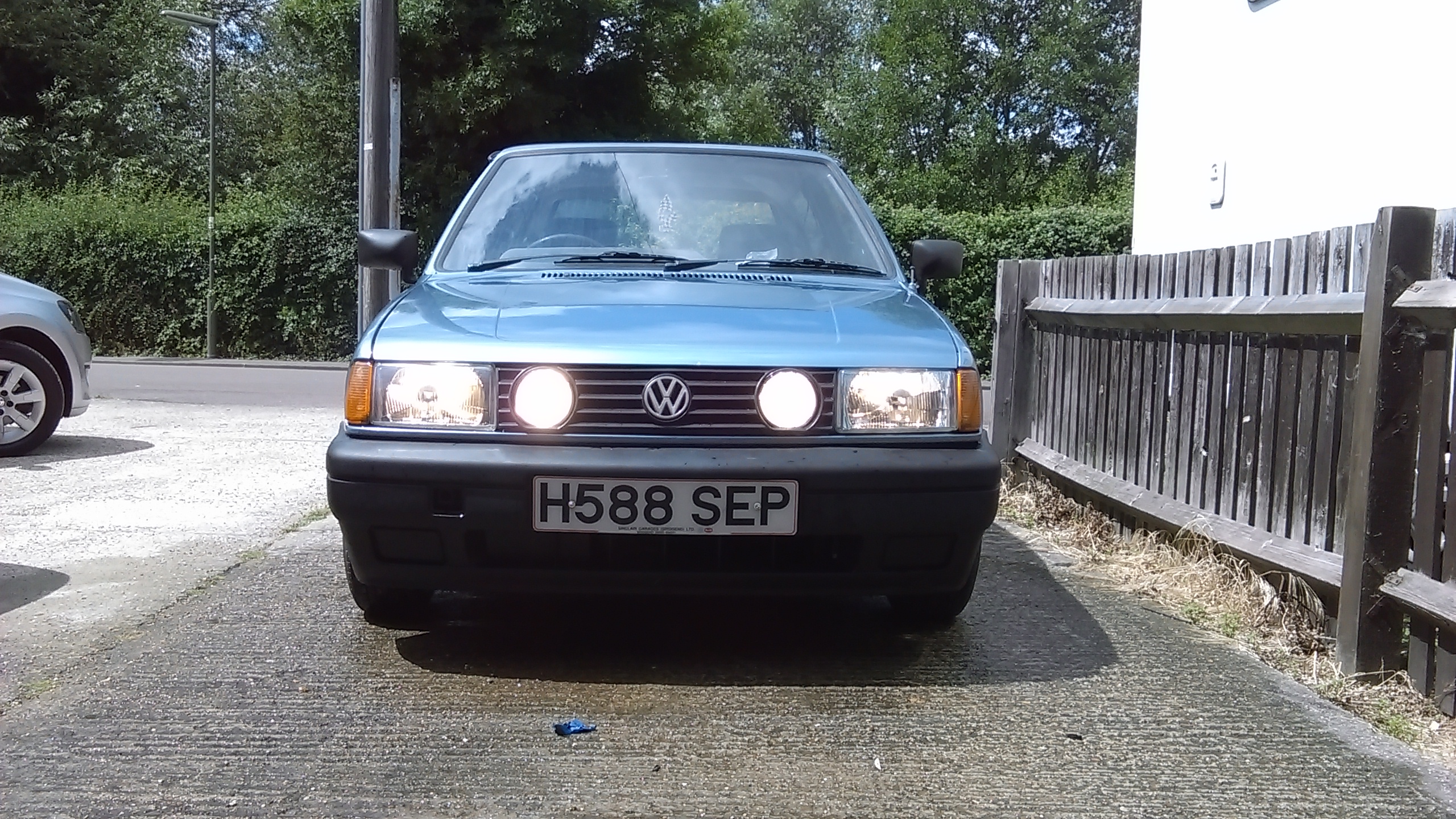

Also got a pic with the votex lights on and a pic showing a crack that I made in my driver mirror, Luckily it's the broken one that does not adjust no more and need a new one anyway.

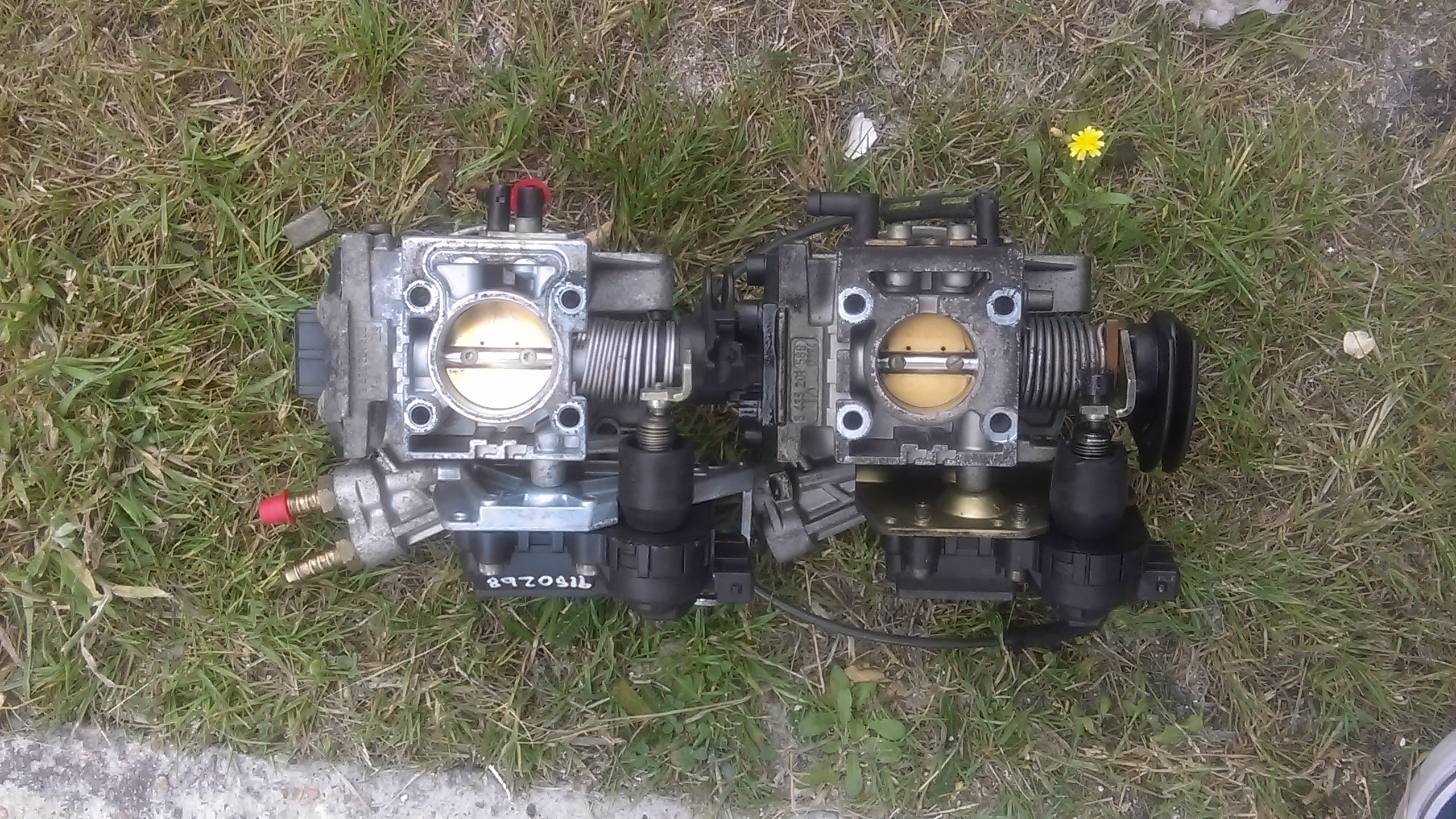

been digging old threads that claim on SPI polos and mine specifically can take a throttle body from a golf mk3 and looking at all the connections I couldnt see how that was possible but after digging around a bit more I found that what they meant is i can do a straight swap with other monopoint injection units from golf mk3's.
Anyway I have ordered the biggest one in true greedy style which will probably see me lose about 5 or more mpg but the biggest gain in power. Its from the 90hp golf mk3 1.8 and is seemingly a straight swap and this also looks like the case.
I doubt ill see good gains until a high lift cam and suitable exhaust system and what not is acquired but I thought I would order it while the money is spare. In the end if i can reach GT power ill be very very happy with it after all I can also decat my car with the year so I think it makes it that bit more reachable.
Today my golf injection arrived and I fitted it, it took swapping some connection parts of my old injection unit which were straight swap, I then had to put the throttle wheel the other way round and it was a massive hassle tbf, straight swap bolt off bolt on it wasn't.
Review is: the sound is amazing
, not just an induction roar but the engine has a slight growl that's more amplified than before. Throttle response is a bit too responsive and I need to get used to it but it likes to rev a lot more. It really is noticeable.
I took a picture of the difference in inlet size
I will take a picture to show that what nige feared about mani hole being smaller is not, and that luckily the inlet size on manifold is now exactly the same size of that on the new injection
It's hard to get a good picture but take my word lol

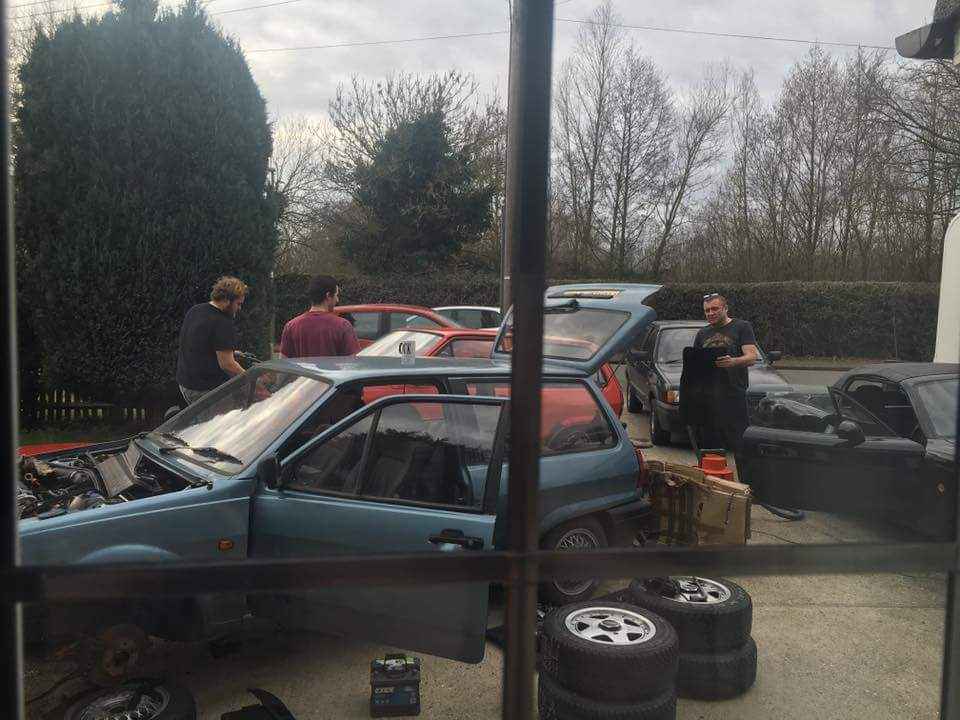

Project plans have changed just a tad since taking a travel to crawley where I met Kiran to see about an engine. 150 bob later I have a GT block a five speed mount and an SPI unit for the current engine! Bargain if you ask me as I also got a head chucked in with the possibility of double valve springs so will check that later too. Just need to get everything else now but I blew 100 quid on a night out in reading last night so I set myself back a bit [emoji52]
Kiran was kind enough to take me out in his GT which was lovely and much pokier so I think I'll be pleased for a while with a GT conversion...his car also made me really want rocco seats which are sooo comfortable compared to mine.
Thanks again for everything Kiran your a top guy [emoji106]
