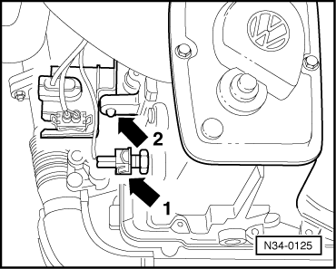

She's a good little car though, for £380! But sluggish on hills and the gearbox doesn't select fantastically and crunches into reverse quite violently. But other than that a good little runner.
