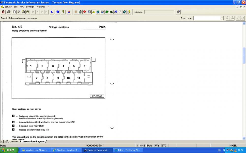

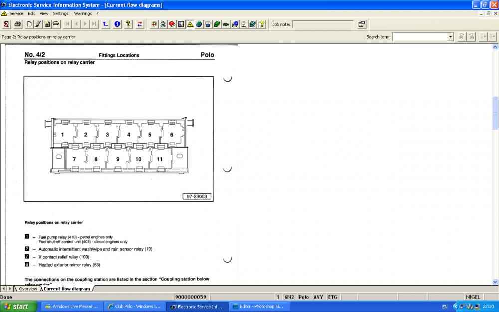

As those items are supplied by the "X" contact relief relay, I would start by replacing that
Thanks Nige! Where is this relay located on the car?
Cheers
It's behind the main fusebox on the relay carrier as shown below Position #7
