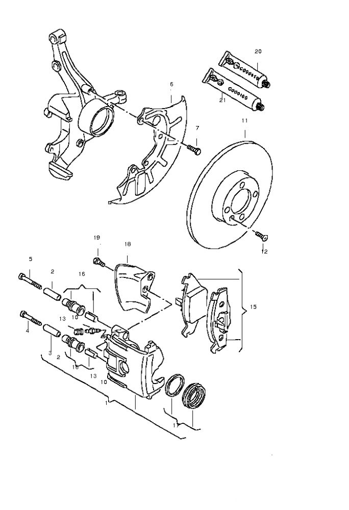

brake caliper housing / Brake Disc (vent)
BENDIX 239X18MM /
left /
right /
guide sleeve
45MM /
guide sleeve
35MM /
allen key head bolt
M8X49 /
allen key head bolt
M8X59 /
splash shield for brake disc
left /
right /
hexagonal head bolt
M6X10 /
bleeder valve
M10X1 /
(11) 6N0615301C
Brake Disc (vent)
239X18 4/100 /
countersunk bolt
M6X15SP /
dust cap
1 set: brake pads for disc brakes / for models without anti-locking system
(15) 6N0698151C
1 set: brake pads for disc brakes / for models with anti-lock brake system -abs-
1 set: guide bushes
set of seals for brake caliper housing
air guide
left /
(18) 6Q0615194
air guide
right /
hexagonal head bolt
M6X12 /
post-36925-0-60948100-1417525911_thumb.p
#16 is the part number shown in that ebay link
