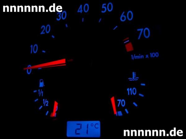

Yeah thats absolutely right Nigel, green plug Pin No 26.
The other pin of the sensor needs earth, minus, or whatever you call it.
I know that cos i do have a british 6N2 GTI Speedo in my Livingroom with that outsidetemperaturesensor outside on my balcony to see the outsidetemperature.
The 2nd sensor from the left is the polosensor:
... and you can see all here on my homepage:
http://www.vwpolo6n.de/polo6n/krimskrams/recycling/tachoalpha.htm
