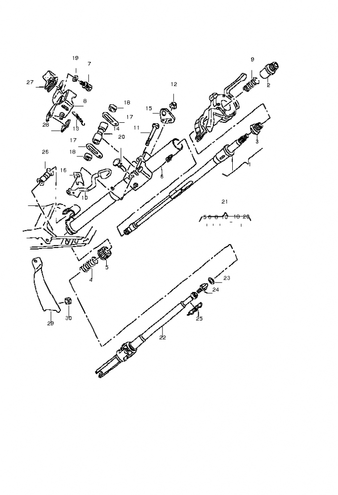

Secondly, I have play on my steering,.. I have checked over the whole of the front of the car and narrowed it down to what i think may be a worn UJ on the steering column just behind the steering wheel causing about 1/2" of play,.. that or the splines aren't too healthy. as anyone seen an exploded part diagram of this system?…. and do you think it will be dealer only again?

Here's the Steering column diagram
post-36925-0-65970900-1417981279_thumb.p

had it up on the ramps and checked it all over,… bushes are fine,.. track rod ends etc, bearings,.. it's all solid, the play definitely feels and sounds like it's right behind the wheel,… I should remove it and investigate.
