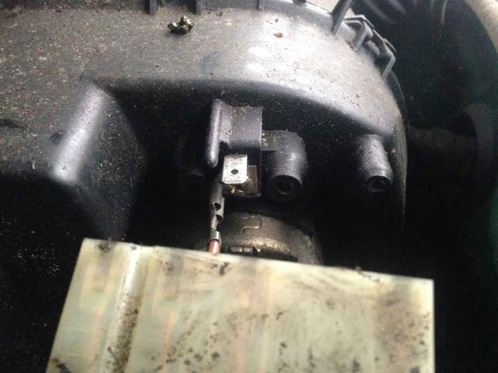

I have received a refurbished heater resistor thanks to vic on here BUT, i didnt take a photo before i took it off so dont know how to put it back on!
I know this is daft but a photo/explanation would be a massive help ASAP

There's only one way it'll fit :)
Screws into the side of the blower motor and connects up by two wires (maybe just one, I forget).
There's the red and brown wire that are loose at the minute. Is it only the red that needs to be connected?
does this picture help??
There you go...
Again Vic, thank you!
