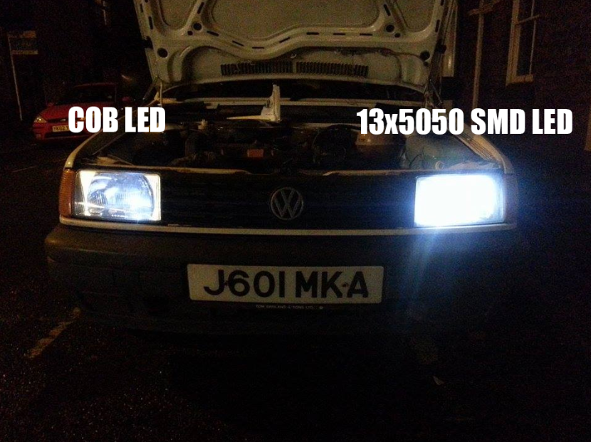

These are what I've got, and I highly recommend. They're uncomfortably easy to damage trying to get them through the hole in the lens (I had to buy a second pair), but I'm pretty convinced they're the best option for the Mk2f if you're careful when fitting.
Pic for comparison with one of my old COBs:

Looks good. I had a present from Santa of a Rayne wiring upgrade. I'll fit with my Nightbreakers and make a comparison with the old wiring loom.
