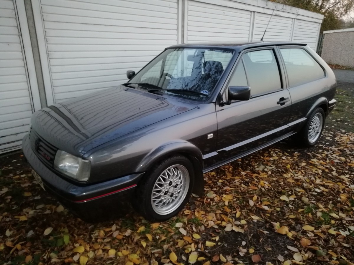

Its first decent run out was to Santa Pod - but like a complete halfwit I forgot my driving licence!
Couple of pics after a buffing session earlier this year
