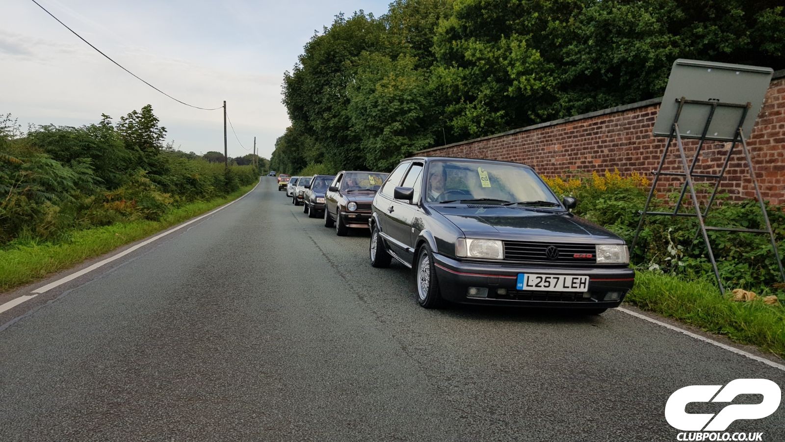

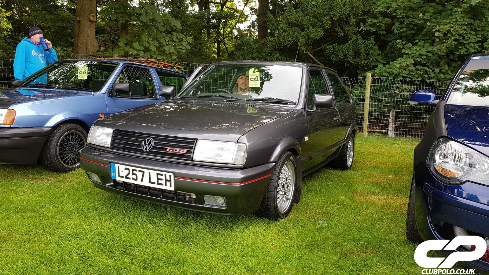

Gave this a good clean and wax in preparation for Tatton Park on Sunday.
This car hasn't made it to any shows since the Polo Social in 2015, so hopefully I can go on Sunday. Unusually, I actually quite enjoyed cleaning it!
2014 was the last time this car came to VWNW, the only change made in that time is the addition of a few stone chips.
large.5986dda1b8b01_WhatsAppImage2017-08-06at08_51_03.jpeg.9de3a4b60c064ed8a3d4fcd2a02c192a.thumb.jpeg.ae535b90d2e48271f020037e103c87e9.jpeg
large.5986dd9903056_WhatsAppImage2017-08-06at08_12_55.jpeg.436d1e075b94b29650c39d7b34ddb55c.thumb.jpeg.a5399530287128f9bcf870943b90dea1.jpeg
Pictures courtesy of @m4ttyf (I didn't have my camera!)

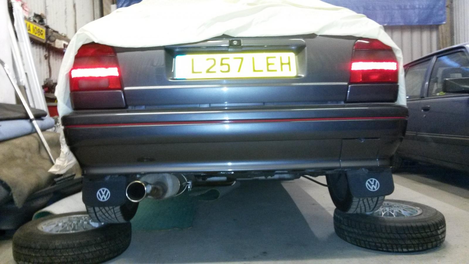

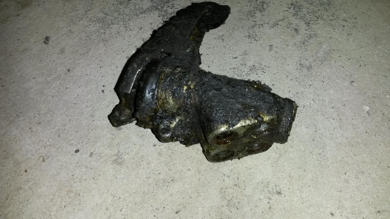

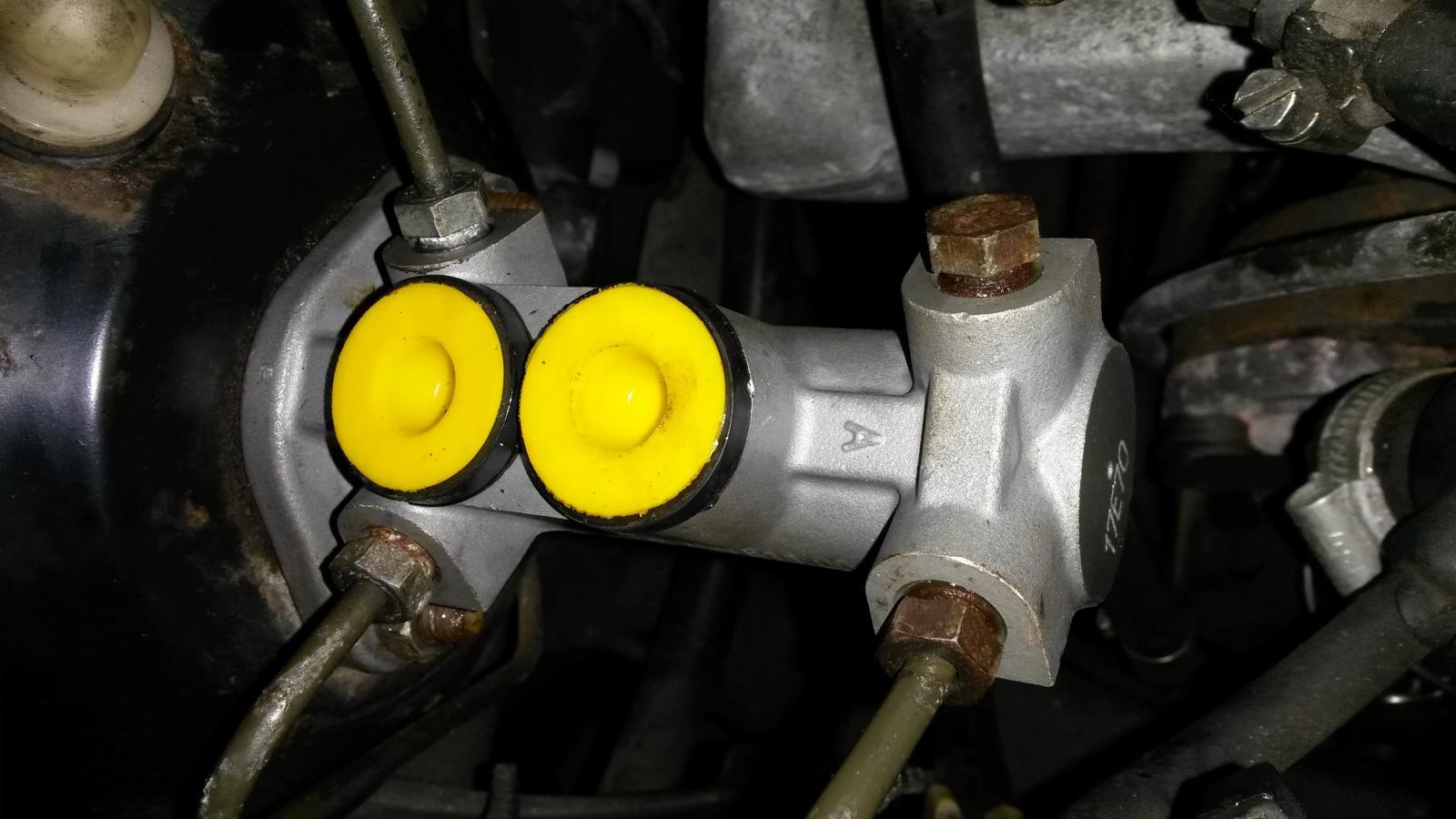

I'd been losing brake juice out of the load compensator valve since just after its last MOT. It was time for a bit of fettling!
Brake fixery happened a few weeks ago - just got round to updating the thread!
The standard master cylinder always had a little too much pedal travel due to the MK2 Golf 16v discs and calipers used, so I thought this would be a good time to upgrade it.
Alloy Golf spec item installed.
The replacement of the load compensator valve would have been a lot easier if the previous owner hadn't spaffed the whole thing with grease. It was a very messy job, and as a result of not wanting to besmirch my phone, there are no pics of the job in progress! I did take this shot of my gypsy style method of safely suspending the rear end of the car at a height that allowed the operation to take place. :)
And this is the failed valve with 99% of the grease and shite removed so you can almost see what you're looking at.
Once bled up with the help of my nephew's right foot, I now have a nice short pedal travel. It still needs to be stood on pretty hard to effect the rapid shedding of speed compared to a modern braking set up, this being down to the teeny tiny servo fitted to the RHD cars - there's simply no room for a bigger one without some bulkhead surgery. 😞 I might* have a go at that next time it's all in bits!

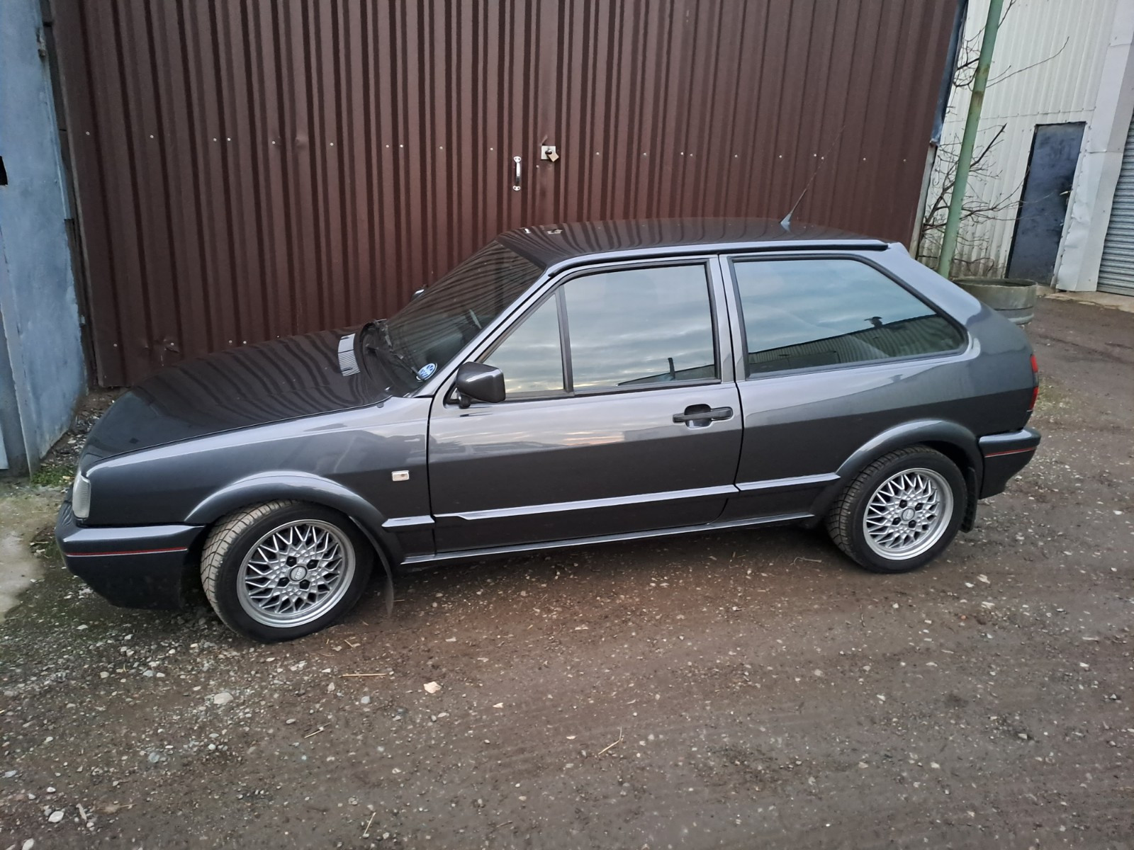

Had a bit of spare time today after a job interview, so with everywhere being nice and dry, I dug this out.
Whilst driving I couldn't help but notice a rhythmic miss fire every 10 seconds - as though the ignition switch was being flicked off then on again. A quick root around under the bonnet revealed that the plug on the knock sensor had disintegrated, effectively unplugging it. I cobbled it all back together again, and the weird miss fire was gone - I guess I'd better order one up!
Had a good ride out in it, then put it back in the garage until next time.  🙂

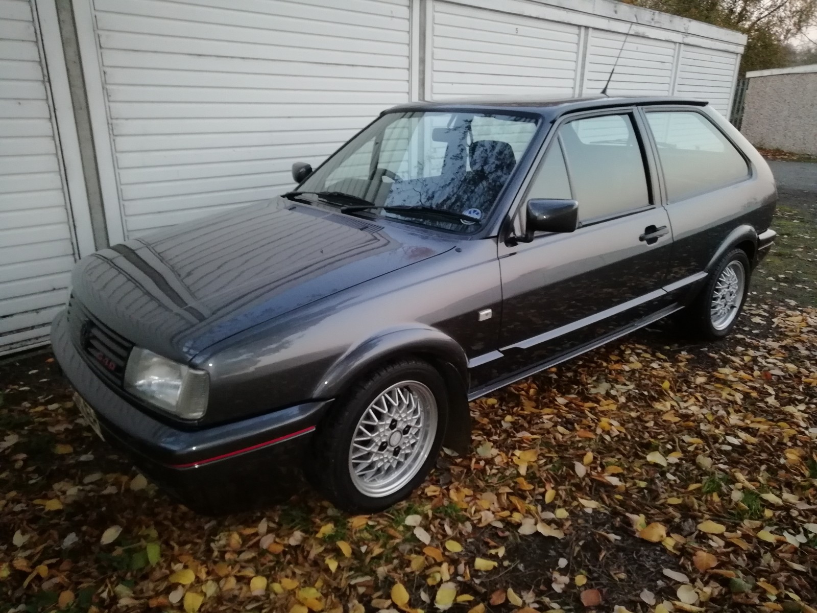

The clutch pedal on this has been requiring more and more effort of late, and today it started to get noisy too. After changing the oil and filter, I changed the clutch cable too - no jacking or lifting required, just a little entry level contortionism and in it went. The difference is incredible - I probably should have done it last year!
Time to put some miles on it. 🙂
My tip for changing the clutch cable is to tie washing line to the old cable's pedal end. It makes threading the new through the bulkhead so much easier.
Gorgeous car! I've found big difference in quality of cables as to how clutch feels.
