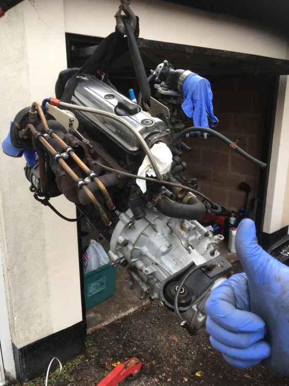

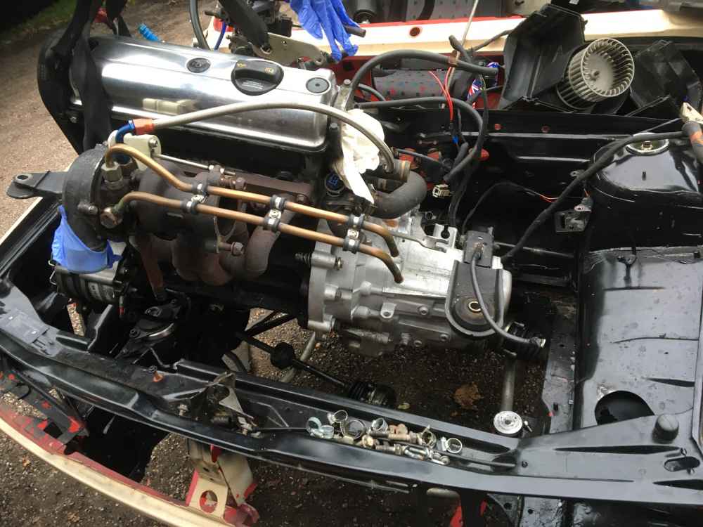

Gt box before it went in, think an 8p would have been better Owell
Awesome mate. Look forward to seeing the turbo conversion ;)
It's a second car so I'm going all out haha ;)

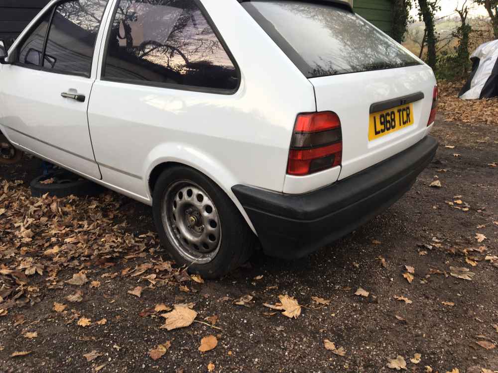

Very nice diy paint job.
Paints abit tatty after 2 years of abuse needs redoing to be honest, here's a pic at a car meet next too a high spec g40 :)

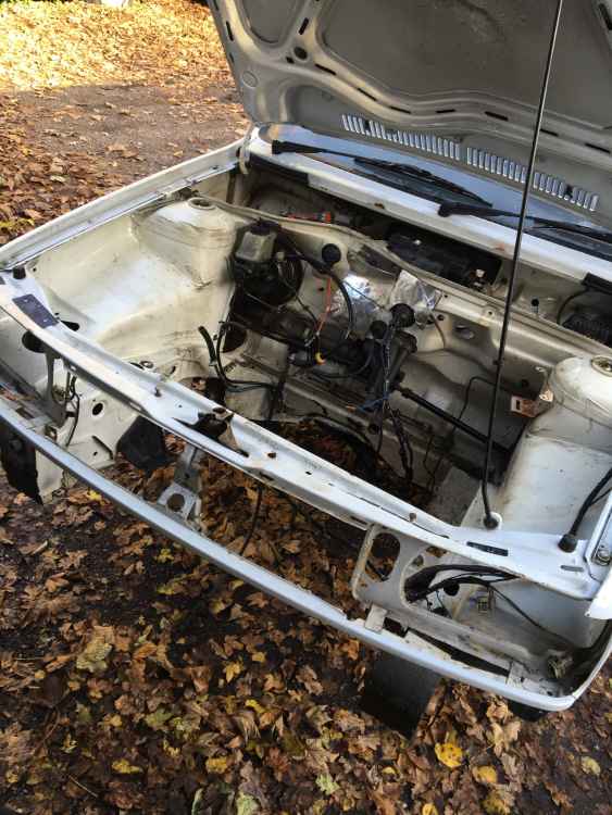

So I started stripping and cleaning the bay ready for paint taking the loom out ect cutting the spi loom and shortining it, so far I've cut the ecu out the loom and now I'm doing some more cutting wrapping ect ect :)
