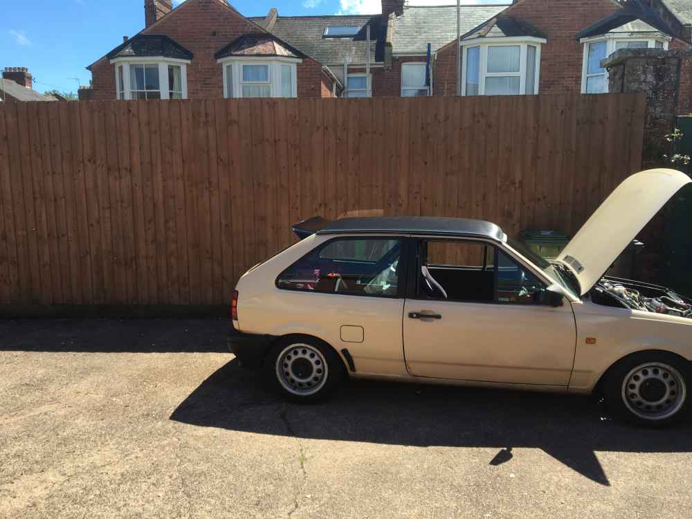

Yeah sump clearance, I've had it sleeved and re welded an inch lower, yeah the black bay has stayed pretty clean so far for a rattle can job, done allmost 700 miles in it this week :) playing with the timing a d getting used to this 8p box
Autosolo at a car show, Think the subframe speaks for itself, need to sort the exhaust out though.

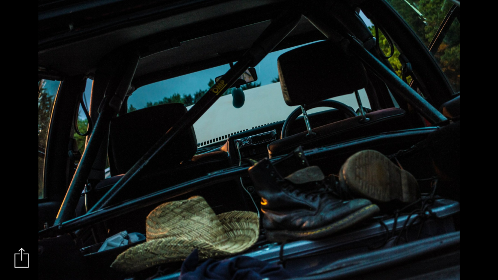

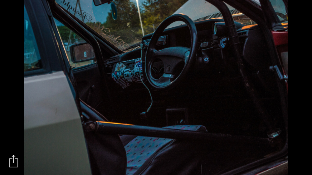

My £3 throttle cable snapped on the clamp. After 530 miles in 8 days, luckily snapped on my driveway haha, here's a couple taster photos, cage still needs abit of finishing off.

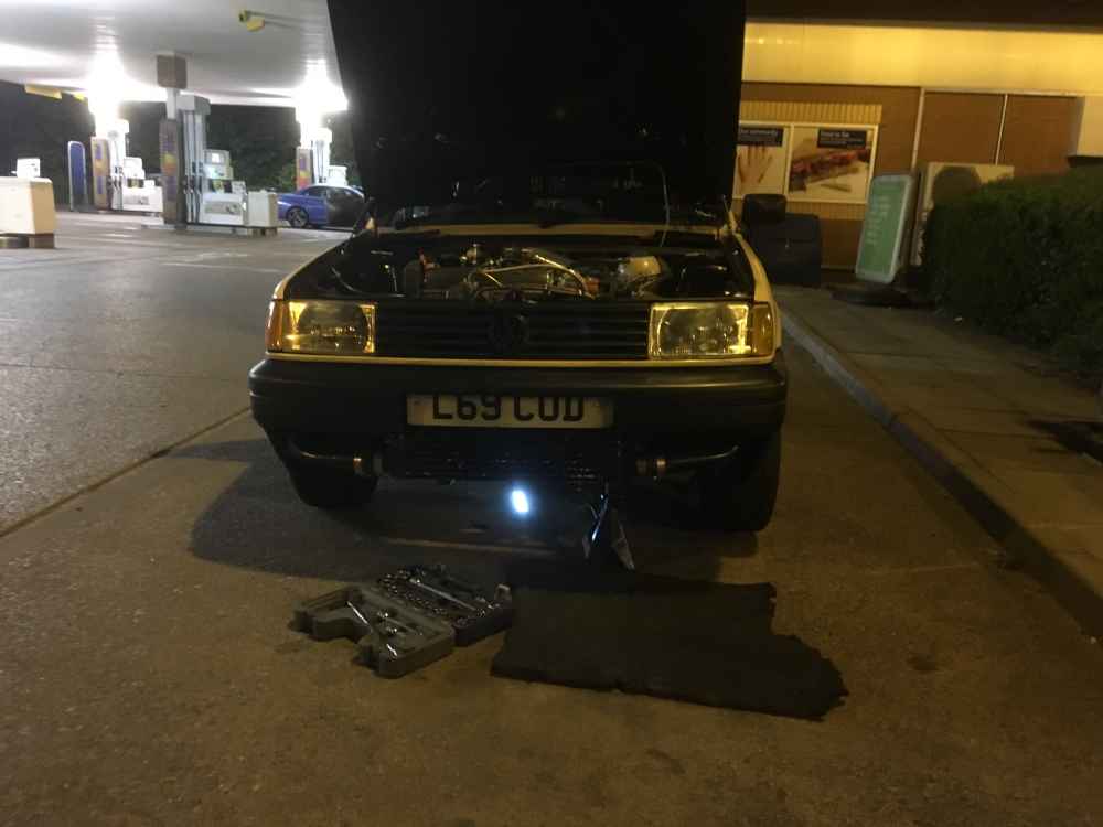

Gear linkage failure tonight, First the bush popped out then the bracet around the ball popped down, managed to fix it to get me home, also turboing a mates saxo at the moment which should be fun.

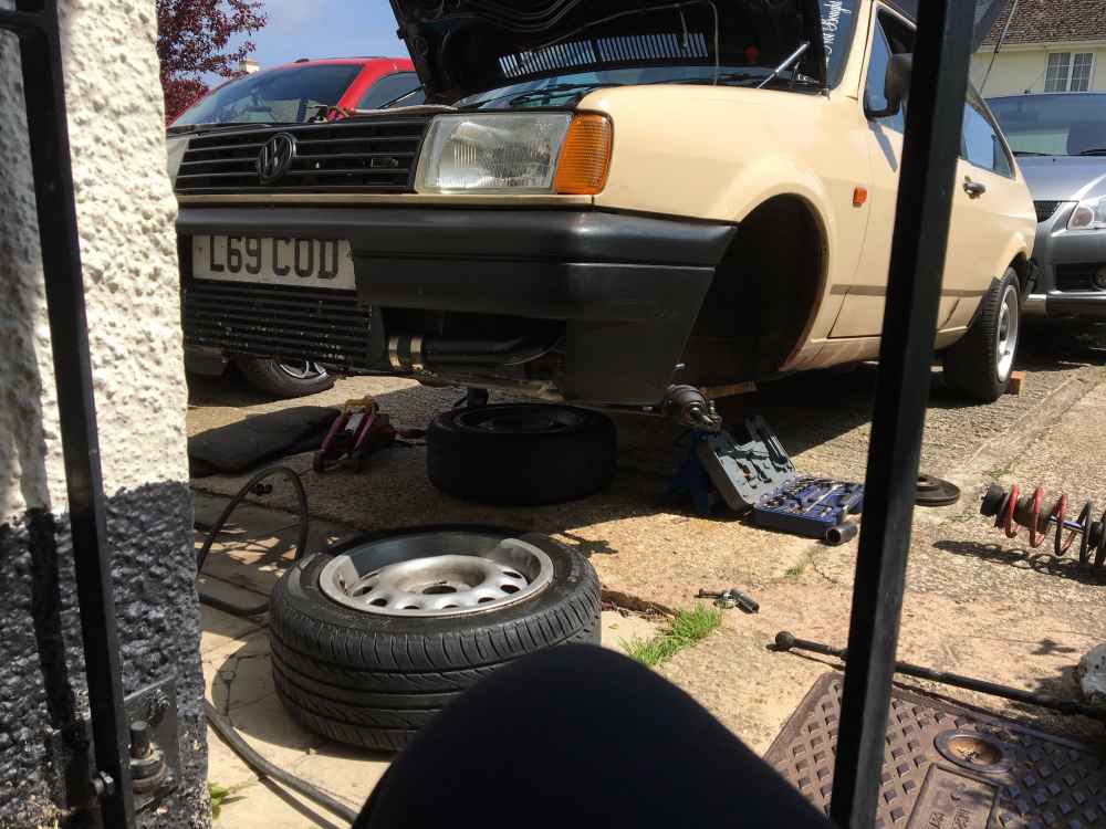

2 new wheel bearings and work on the gear linkage.
