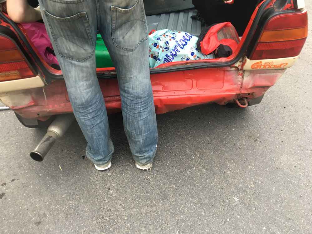

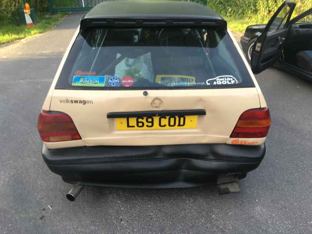

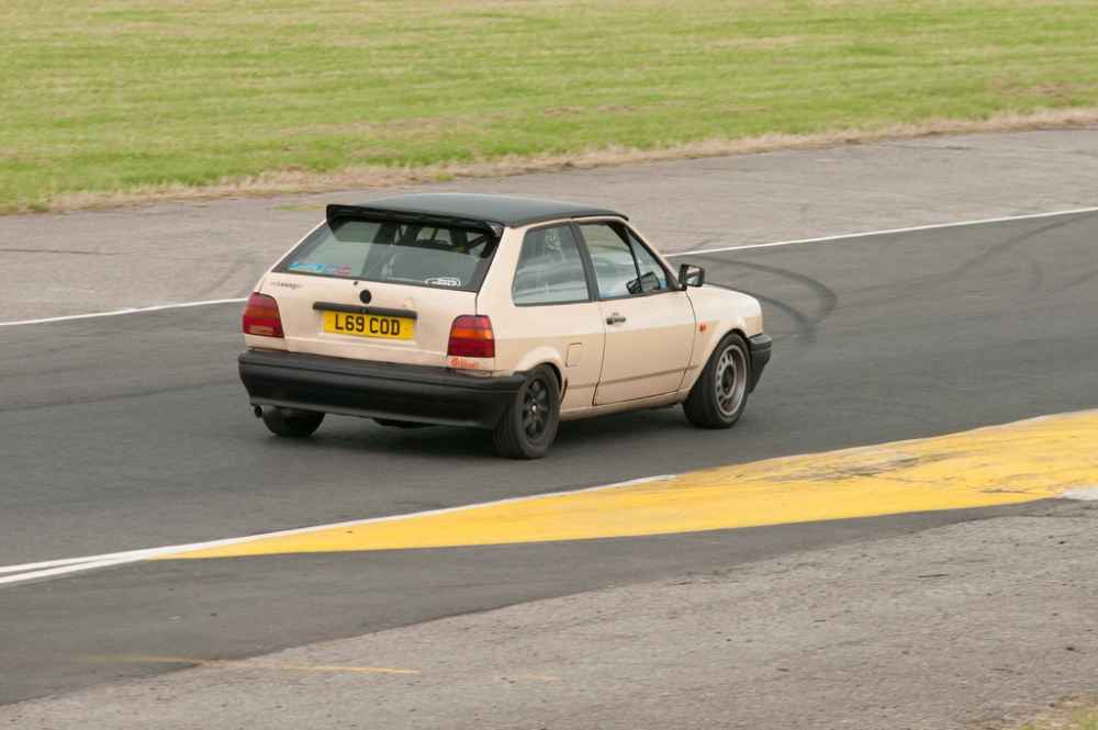

Need a new shell :( got rear ended at a roundabout the night before the trackday, luckily steven and ross were happy to help :D so nice having people who know what they are doing help, and happy i managed to get it on the track, so not a completly ruined weekend.
Good effort, shame you got arse ended :x

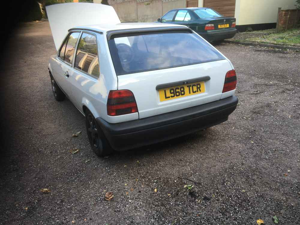

Naa got a clean white shell thats been resprayed last year being delivered today.

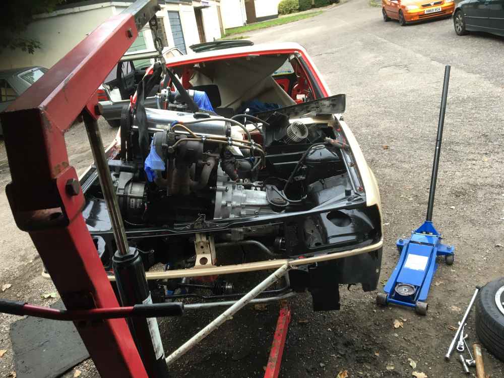

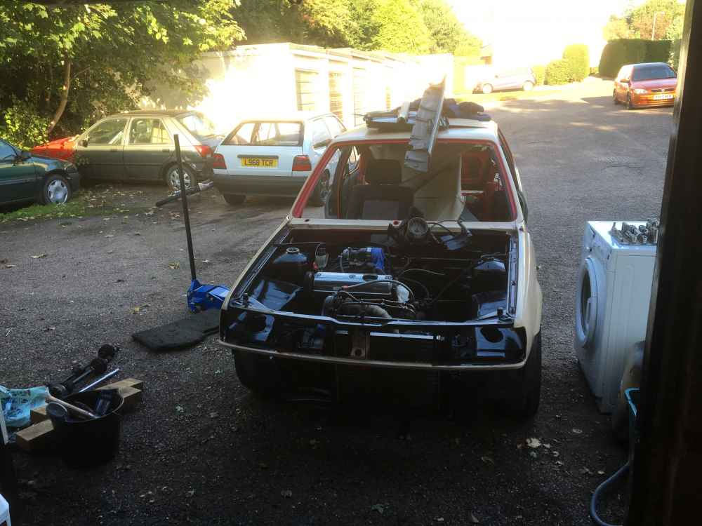

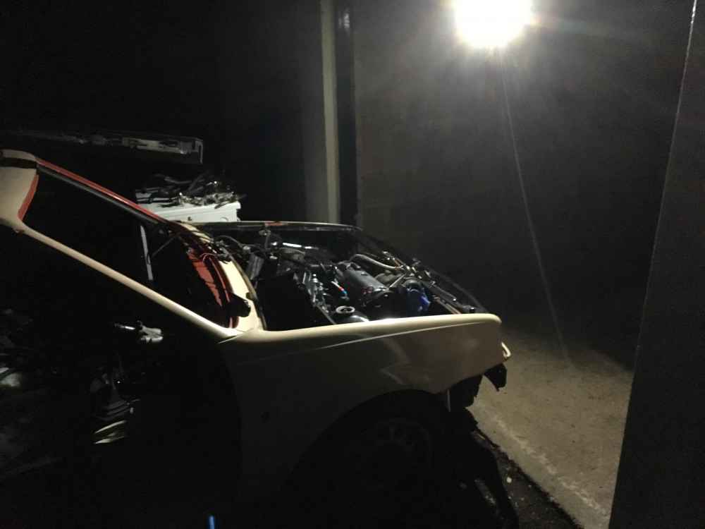

So engine out and general mess of stripping everything off this shell.
Bit more work no big updates :)

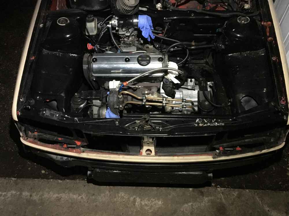

I know this is an old thread but I'm trying to pretty closely copy this build. I know generally speaking I'm looking for a ko3 turbo, I have however seen a few 1.2 and 1.4 golf / polo / Skoda tsi turbos and manifolds for a reasonable price.
In the pictures it looks like the bolt pattern of the tsi manifolds is right for an abd/2g head. Does anyone know if I can use one of those in my mk2, abd, build?

The abd has the same head casting as a mk2 polo, just different internals, and the later abd head had 7mm valves.
I'm fairly certain a TSI manifold won't fit, my manifold was a stainless Toyota starlet manifold with both the flanges changed.
