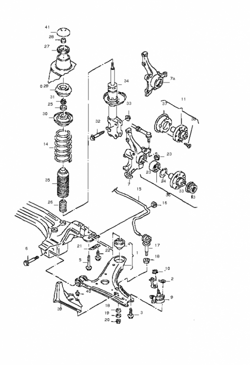

The ARB is clamped onto the front subframe and connected to the wishbones by drop links The roll bar comes in different diameters 18~22mm the AFH uses a 20mm as standard
post-36925-0-20115900-1424291369_thumb.p
15 6N0411309 stabilizer 18MM /
(15) 6N0411309A stabilizer 20MM / AFH,ANM,AFK
(15) 6N0411309F stabilizer / also use: 22MM 6N0 411 315 D / GTI:AJV
16 6X0411313 rubber mounting / F >> 6N-X-300 000* / for stabiliser: inner 18MM /
16 6X0411313 rubber mounting / F 6N-X-300 001>>* / for stabiliser: inner 18MM /
(16) 6X0411313A rubber mounting / F >> 6N-X-300 000* / for stabiliser: inner 20/22MM /
(16) 6X0411313A rubber mounting / F 6N-X-300 001>>* / for stabiliser: inner 20/22MM /
17 6N0411315 connecting link / for stabiliser: 18MM /
(17) 6N0411315A connecting link / for stabiliser: 20/22MM /
