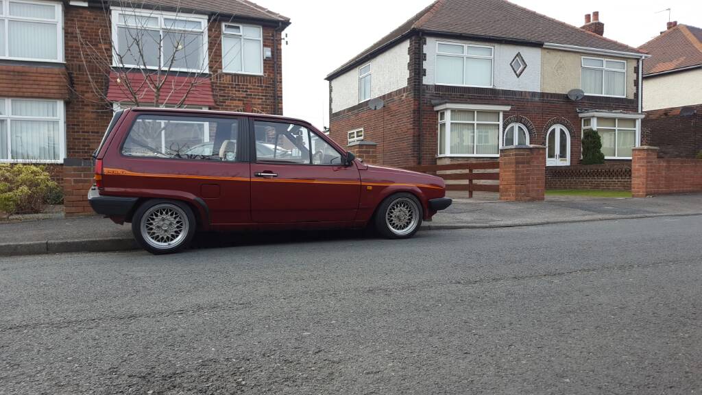

well had a busy weekend first it started with removing the side strips, a good wash and putting my decals on

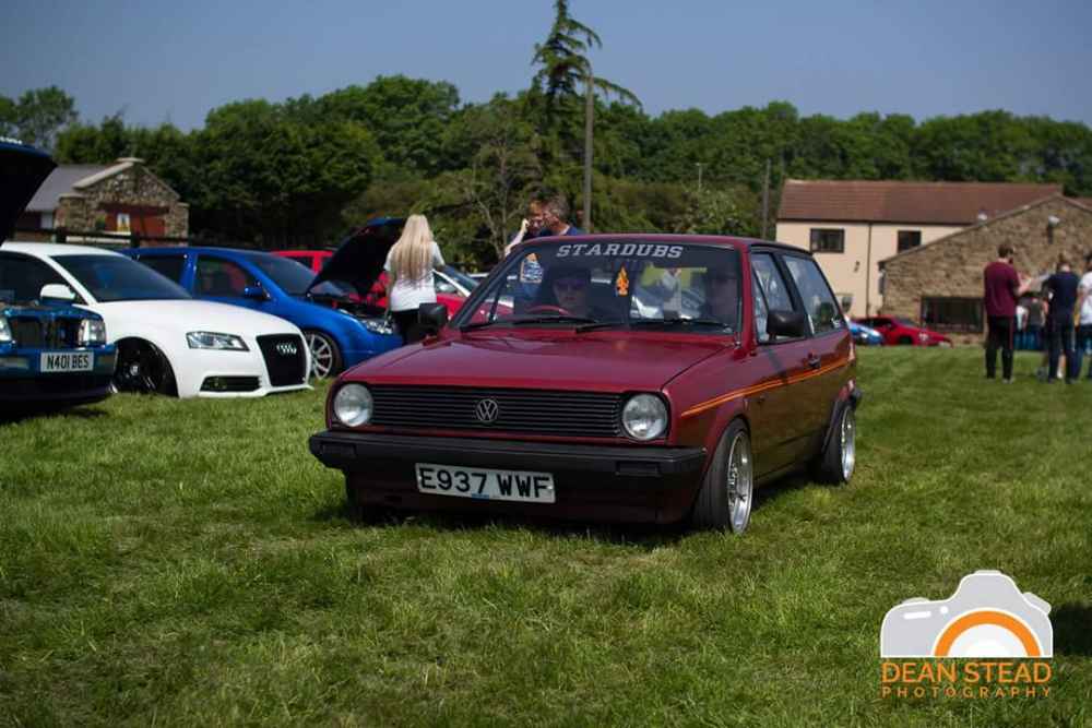

then Sunday was show day
came away with best clubstand at elsecar at the races aswell

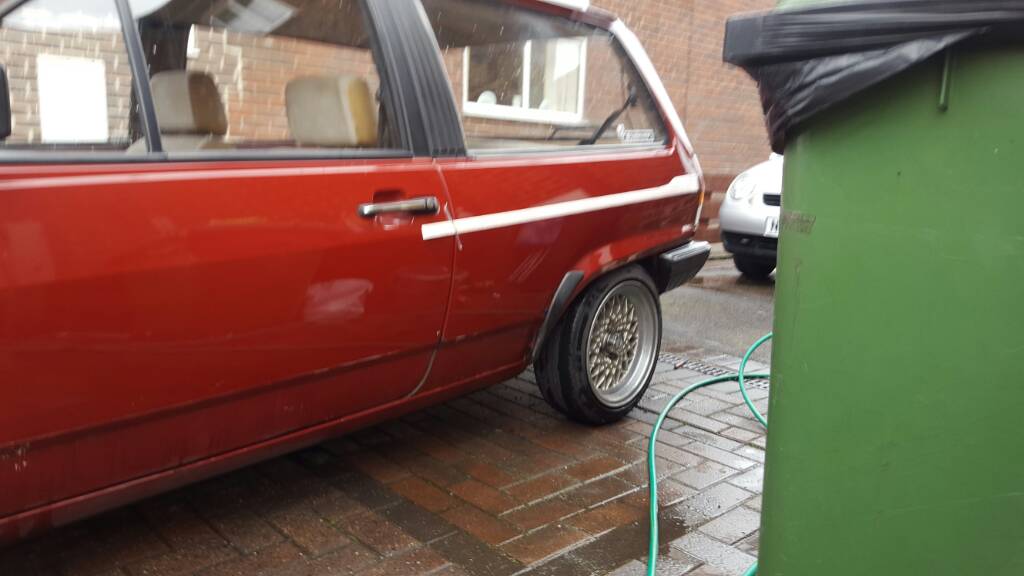

I love those decals so so much, but personally I think I'd cut the bit on the round bits of the front arches off so it follows the lines of the car a bit more if you get me?
Either way where did you get them from if you don't mind me asking?
yeah that's how it was on the photoshop was think I'm gonna do that

Ok thanks a lot mate
I agree the decals should be trimmed around the arch curve :) looks bloody awesome this thing now! Not bad at all for a first car

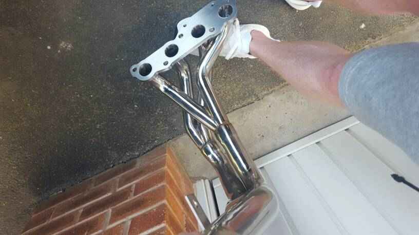

also this beauty turned up today, decided to go ahead and upgrade as I've managed to crack my current downpipe around where it joins the manifold. So i thought this gave me a good excuse to upgrade. Hopefully be off on tomorrow as my car currently sounds like a tractor

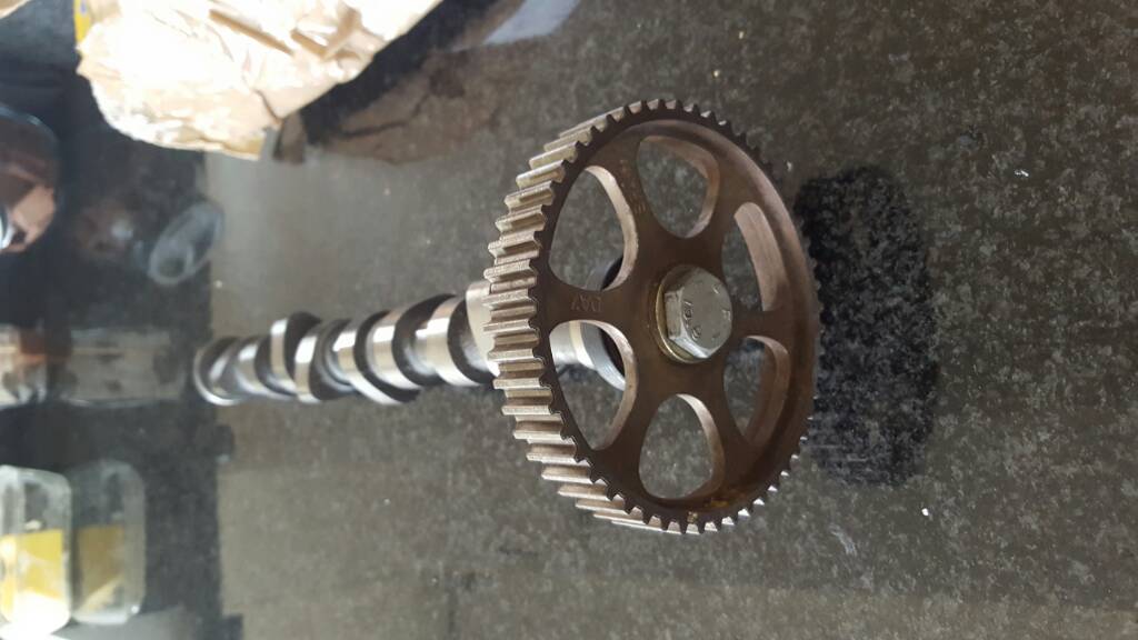

right ill be picking these 400cc carbs up along with a gt cam and possible head, just wondering what sort of power would I be looking at?
Sent from my SM-G920F using Tapatalk
853ef49a910d441bd959ec7ccec9dc78.jpg&key=02b8ff577e6c2d7aef4839aab78f50a129e8c7760734020458a416f662a04bb9
Be interested to see what it's like once you fitted all that because I'm hoping to do a very similar thing ASAP
I wouldn't bother swapping the head unless you need to do the head gasket or something. The head on your engine is the same as a 1.3 head. The only difference between this and a GT head in reality is the double valve springs. The ports on a GT head are slightly bigger but we are talking 1 or 2mm at most. The valve sizes are the same. For the work involved in swapped the head I doubt there are any gains to be had from that alone.
I'd just stick the GT cam in your head and leave it at that.
Power wise it depends on how well the carbs are set up and what jets you are using. Ideally getting them set up on a rolling road by a place that knows how to tune carbs will see the best results.

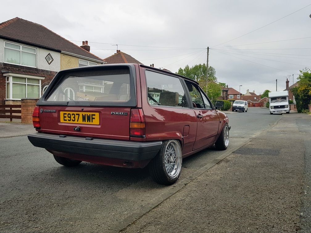

Been over a year since an update thought it was about time.
Kept using the polo as a daily and to goto shows
Then took the polo off the road and bought a daily. a tidy 320ci thats doing me well so far.
How it sits atm, i've decided its time to get some work done on it and my motivation is back. The end goal is to get it rust free, repainted, new seats, suspension revamped, new engine and alot lower!!
If anyone can point me in the direction of where i can get new panels from that would be a great help. Hopefully keep these updates fairly regular when i get some work done on it.
