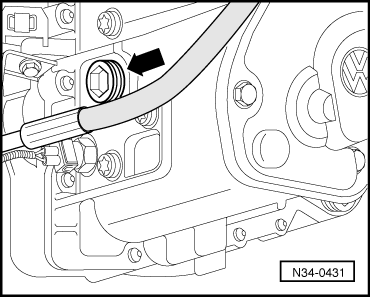

Under NO circumstance put any oil down that plastic cap, you'll cover the clutch in oil !! the Fill/Level port will be on the front face of the gearbox it's a 17mm allen key to undo
post-36925-0-68315300-1426170180_thumb.p
DO NOT undo any of the other bolts on the front face or you'll be removing the gearbox and rebuilding it !!
The capacity is 3.4L but fill it till it dribbles out
That connector, when it left the factory there wouldn't of been any wires visable but with time, removing/refitting they have worked loose from the clamp, but it won't have any effect, you might be able to tywrap the wire covering to the connector

Is it possible to get to the fill hole with the gearbox in place? I can't picture it on that diagram so I'll have another look when I go out again later.
Thanks for the capacity, I'll order some oil along with the gasket. I'll have to get a 17mm Allen bit as well, as i don't have one.
It shouldn't harm anything with that plug open, but it would be better if you can close it, might need a tap to get it to seat :)
The fill/level is accessible without removing the box, lay on your right side with your head towards the passenger wheel, look up and you'll see the wires going to the reverse light switch and just above and outwards you will see the 17mm plug

Early 6N's the fill/level is also on the diff case, but the later ones they fitted it on the front face as in the picture :)
