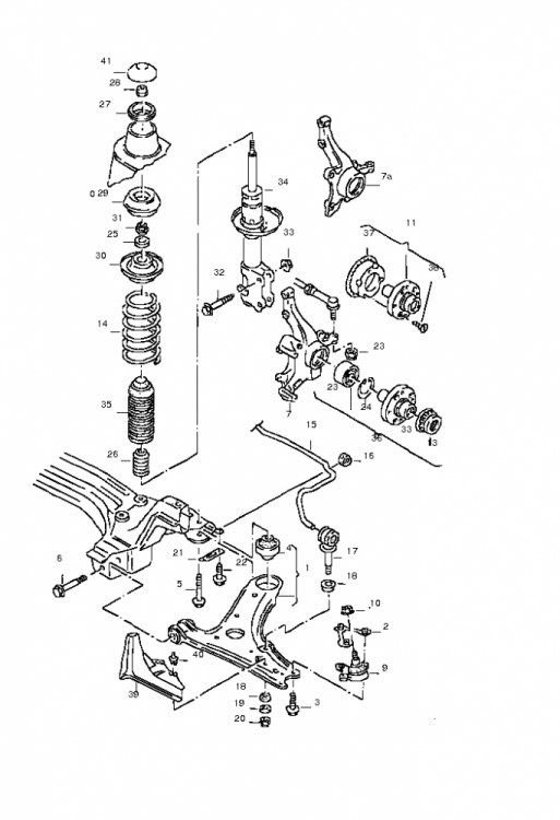

Ok, have ordered it, and some new drop links. Can anyone advise where to get brackets for the ARB? I have the bushes but can't find where to buy brackets, or even if they are needed?
You need item # 21 in the picture it will be VW or TPS to supply new, they are listed @ 1.5 €uros in Germany

(21) 6N0411337 tab / F >> 6N-WW121 184 / F >> 6N-XY038 189
(21) 6X0411337 tab / F 6N-WW121 185>> / F 6N-XY038 190>>
(22) N 0195194 hexagon head bolt c/w shoulder / F >> 6N-X-090 000* M8X16 /
(22) N 0195194 hexagon head bolt c/w shoulder / F 6N-X-090 001>>* M8X16 /

I'll need "5" as well?
Tried googling the part numbers but no idea where to buy in the UK?
(5) N 10319901 hexagon head bolt (combi) AM12X1,5X80- SW18 /

The 1.0 and 1.4 8v 6n didn't come with an ARB, the 1.6 had an 18mm, 1.9D a 20mm, and 1.4 16V a 22mm ARB.
I'm not even sure if the 6n2 8v's had one, but the 16v's do.
I'm currently in the process of fitting one on my 8v (18mm).
things you will need:
2 of these tabs (from VW or TPS as nige said)
2 of these bushes (£5 each on ebay)
2 of these droplinks with bushes and bolts (£25 a set on ebay with everthing included)
2 M8 x 16mm Bolts (22 on the above pic)
I'm not 100% sure if you need the M12x 1.5 x 80 (5) as I have no markings on the tabs to reflect their use, and it does look like they bolt through the rear wishbone bush, but will confirm when fitting I guess haha
also to note, make sure you get the correct size bushes/droplinks for your bar!
