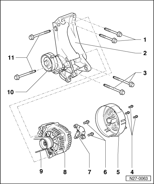

post-36925-0-34249000-1427324633_thumb.p
Thanks very much for clarifying that and for posting the diagram. I knew it was going to be one or the other but wasn't sure which. Am I correct in thinking the logic is that when a simple belt arrangement is present - i.e. no PAS or aircon it's the spring mounted lower alternator mounting tensioning arrangement but, if a car has aircon or PAS or both, then the more sophistcated tensioner roller mechanism is fitted to cope with that situation and the more convoluted belt path it inevitably entails? Is my logic correct?
With No PAS or AC the alternator bolts direct to the engine
With PAS it uses this bracket assembly to mount the Alternator & PAS pump
post-36925-0-07462900-1427369195_thumb.p
With PAS & AC it uses this bracket assembly to mount the Alternator, PAS pump & AC compressor

The tensioner unit can be replaced as a separate item
Thanks again for the extra diagrams and clarification - I wasn't aware of the different brackets arrangement depending on the specific options fitted to the car. It's quite a neat solution to coping with the different belt configurations that can exist and your posting will hopefully help other club members who might be wondering how things work. I've been doing some research as to which replacement belt I need as there appears to be several different belt lengths depending on whether no PAS or aircon is fitted, aircon only, PAS only or PAS and aircon. Since I have PAS but no aircon I think I need either a 1063mm or 1070mm 6 peak belt. I'll check with my local branch of GSF in Nottingham to be sure.
