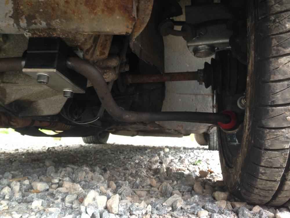

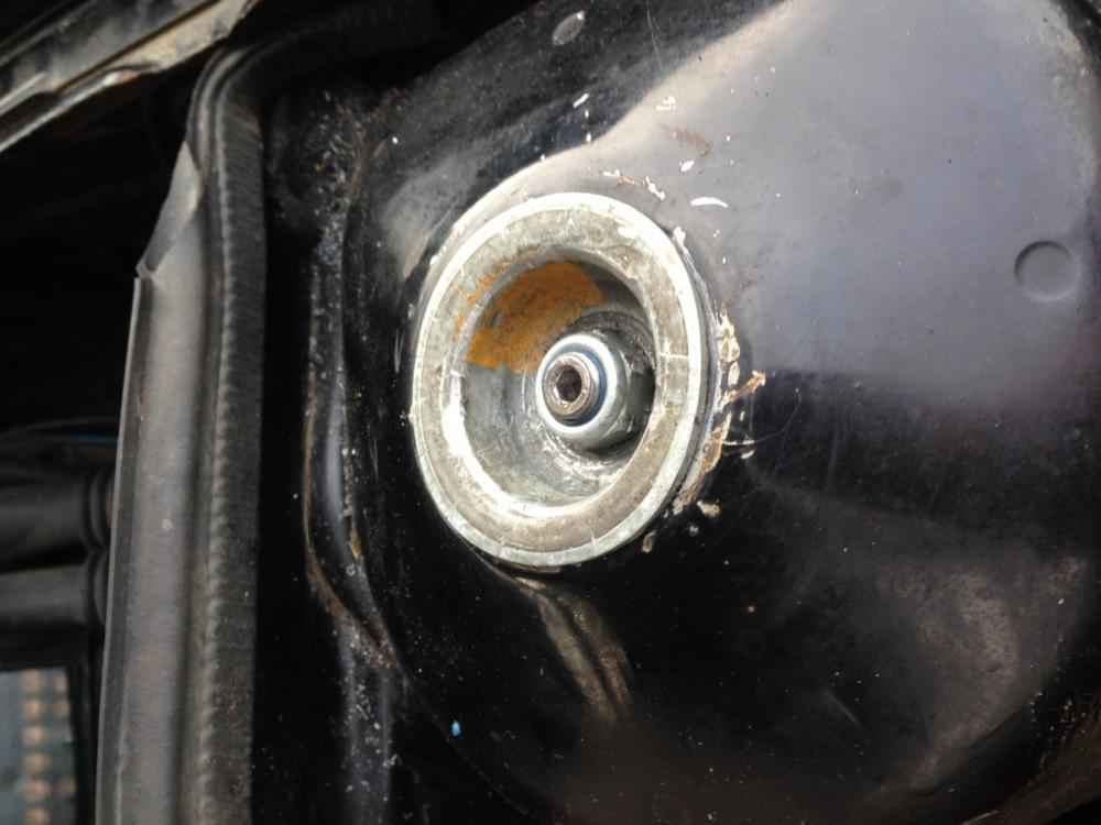

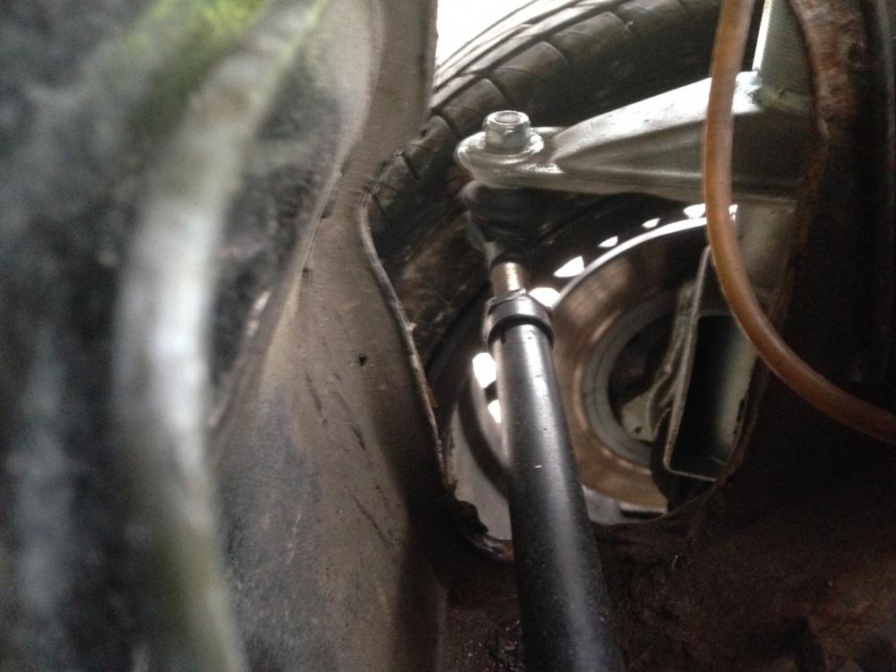

Here you go all, a few pictures of the set up. If some could please help I'm really stuck here, even if someone from East Sussex could come check it out. I've worked a Golf Cabby loads but these are very different cars lol
Thanks
Zack

theres sposed to be a big washer both sides of the arb on the end bush
Here's a photo to help, can see a big curved washer either side of the bush.
D9CDC8A9-7EEB-4F7A-A170-B5FF31BB4F8B_zps
Also, I'm sure there should be more thread coming through the top of the top cap, is the castle nut fully tightened?
tbh if the garage didnt bother with the washers which in my mind are obviously needed to stop the bush pulling out , then what else have they left off or bodged up
kinda thinking it needs going over to see what else theyve left off
not much thread showing out the top of the steering end either
Edited by steveo3002
Yeah I see what you mean with the garage although that was the only thing they did, I'll try putting a washer on the other side as well and see if that makes any difference. I'll also double check the tie tod is as tight as possible. I thought the thread at the top was pretty low when we fitted it to be fair but its real tight. When you say castle nut I presume it's the one at the top mate?

Hey, don't remember if I mentioned this before but the top silver plates spin and lift when the wheel turns. Any ideas?
It's suppose to do that :)
Top nuts as previously mentioned should have more thread showing I'm sure, surely they go down more or maybe the special castle type nut may not be all the way down and stopping the top cap nut going down enough
Edited by wizardmanjm
Are they really supposed to?! Surely they aren't clamped down enough on the chassis for that to happen?
There is much more thread now than what was before but it still didn't work.
That will happen unless you get lowering top caps which aren't as deep, on the top caps you have on the pic the thread should be way more, I think its 6n top caps that are best used for lowered mk2s
But we managed to get the thread far further through than that. Would the top caps really make a difference? I don't follow how basically lol
