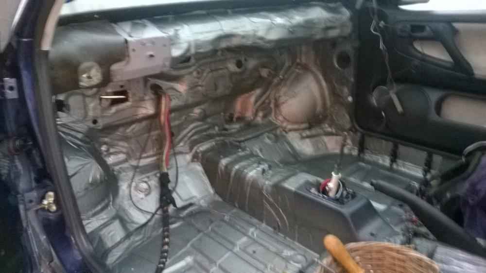

I am currently having a go at this on my 6n and doing it better then before. I am using aluminium backed flashing board tape, this is bitumen butyl type material with a aluminium backing. I have done the entire bulkhead and front floor so far and tbh this is the main source of road and engine noise but is usually not done by most because it involves taking the dash out and everything between it and the bulkhead. The rest of the interior is a walk in the park.
Over this if you were really seriously trying to get rolls Royce levels of deadening you could use closed cell neoprene sheets and or the fibre type material they fitted at the factory. I went with the factory stuff but instead I glued it down meaning it's now part of the bulkhead as apposed to just resting on it.
I attached a picture of the finished result of the flashing tape- that's 20 meters worth and cost me £18 plus vat so £80-90 would do the rest of it I think. I doubt the underlay is that much cheaper really.
£80 worth of dynamat would have covered the area I just did and maybe a bit of the rear footwell so really not bad at all.
