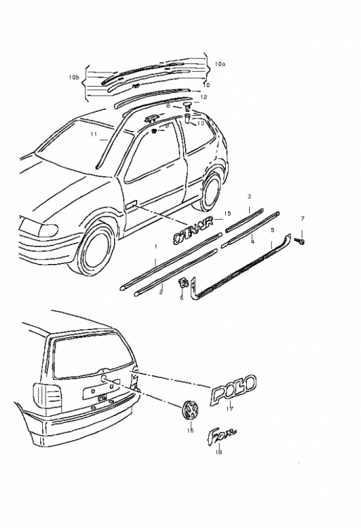

Here's a photo with some arrows to show what I'm on about :)
6N3867365D door seal 2 doors /
6N3867365D DQX satin black/pearl grey
6N4867365D door seal 4 doors /
6N4867365D DQX satin black/pearl grey
They will be VW/TPS to supply, listed @65 €uros in Germany !! So you might be better looking for someone breaking a car?
I think that's the one that goes around the whole lip, this one is on the top, runs right next to the rubber that covers the roof rack mounts, then down the pillar.
OK not the seal I was thinking of :(
post-36925-0-12662200-1429226824_thumb.p
# 11 in the picture?
6N3854709B roof channel left inner 2 doors /
6N3854709B B41 satin black
6N4854709B roof channel left inner 4 doors /
6N4854709B B41 satin black
6N3854710B roof channel right inner 2 doors /
6N3854710B B41 satin black
6N4854710B roof channel right inner 4 doors /
6N4854710B B41 satin black
Same as other seals for supply, these are listed @ 20 €uros

www.vagcat.com it's a free to use VAG parts site, you need to register first to see the diagrams but that's free :)
