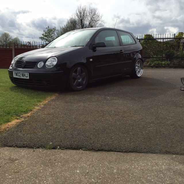

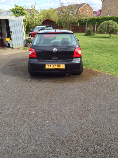

had this car from January, so is I'm only really starting but I'm happy with the progress so far.
The car is 1.9tdi pd100 in black
Lowered on Fk coilovers without adjuster in the rear and no bump stops or helpers
Wheels are original rondell 17" 2pc split wheels 9j rear et30 with 2.5"lips and front are 8j et35 with 1.5" lips

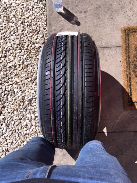

    tyres should be here tonight so will try get them fitted i went for 185/35/17 on the fronts which are 8j, will post some photos up once they are on but this is how she is at the minute.

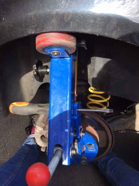

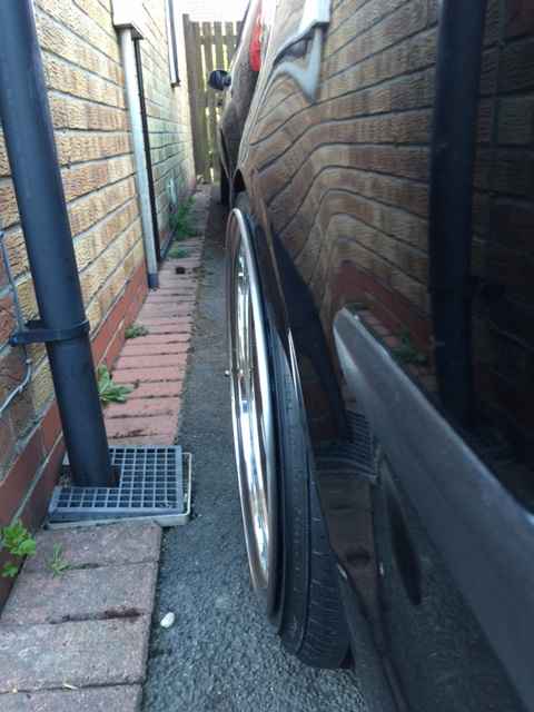

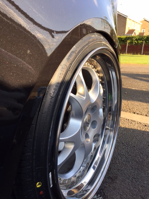

I'm in the process of rolling my arches so will get some more pics tomorrow of the arhces rolled because i cant get anyone in the back of my car without loosing tyres.
Arches have been rolled and don't think i did too bad of a job for my first time with no help, still a little bit of work to make the perfect but the tyres don't rub any more so I'm happy with it so far.

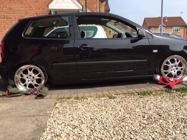

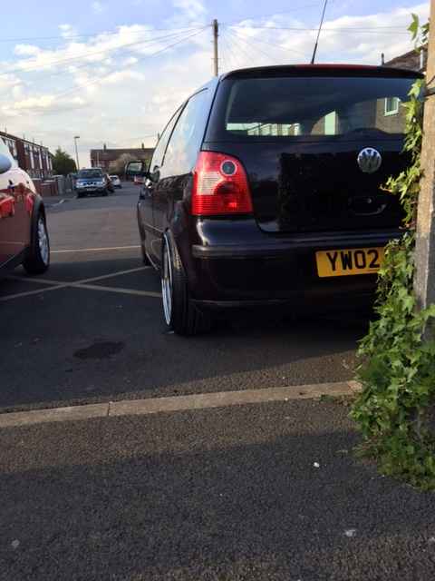

wanting to camber the rears but not sure how many spacers i should use, has anyone put camber on the rear if so can you send a photo, thanks
So started cambering the rears today with m10 washers, 2 on the side closet to the number and 3 on the other but we couldn't seem to get the calliper carrier screws off so think I'll drop it off to the garage to see if the will loose it for me then can start again. Would love to hear some feedback

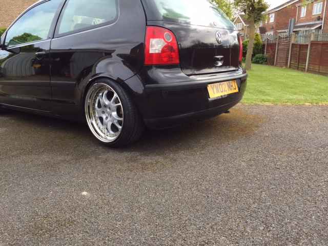

post-915728-0-22639200-1432036007_thumb.
